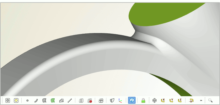

Jörg 29 Report post Posted June 28, 2013 Hi together, Please find attached an example for parametric fillet modeling between two given surface. The parameter "OFFSET" in the scope "filletmodeling" controls the width of the fillet; you can change it e.g. in the range [0.05,0.025]. The fillet is able to change its shape along the "sweep" direction - there is an input called "factor" which can hold a function. In the attached project file, this input is constant and set to 0.5. I use this fillet for manifolds and volute tongues etc. The following steps are defined in the feature definition "fillet":Run along a main surface curve and find the corresponding position on the second surface curve Calculate the difference vector between these two positions Project the difference vector onto the tangential planes of the two surfaces at the two positions Use the resulting vectors for setting the directions of the connecting bspline curveThe object "testing" in scope "filletmodeling" shows how this section definition works. This feature definition is then used for a meta surface. I like these kinds of definitions - they nicely show the possibilities of customized curve/surface designs by utilizing basic math stuff. Intersection There is another feature definition "intersection" which creates two surface curves. This intersection is based on surface curves and surface intersection points - quite nice for demonstrating loops and surface domain modeling. These surface curves are then used later on by offset curves to widen the intersection area (for squeezing in the fillet). Note that there is the assumption that the surface parameter "v" corresponds to the "sweep direction" of the surface. If your surface is swept in "u"-direction, the intersection feature definition needs to be modified slightly. Trimming / Subsurfaces As far as trimmed surfaces are not directly supported in CAESES/FFW, trimming can be realized by using sub surfaces. There is another feature which "cuts" out the hole by using the domain information of the intersection. CheersJoergfillet.fdb 1 Share this post Link to post Share on other sites

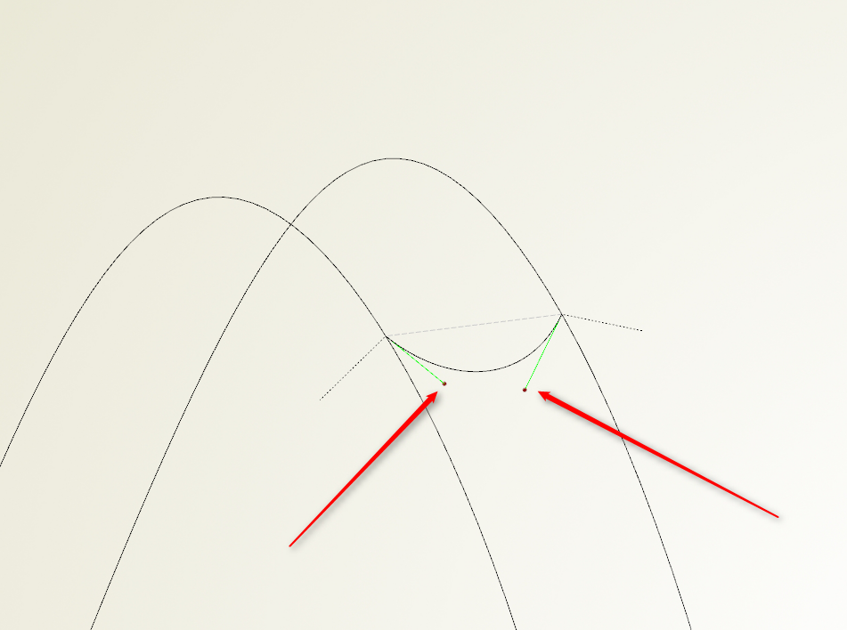

Jörg 29 Report post Posted July 1, 2013 And once again ... here is another version where the tangents of the bspline curve are defined via the normal and tangent vector. I think, this is my favourite generalized version :-) CheersJoergfillet_general.fdb Share this post Link to post Share on other sites

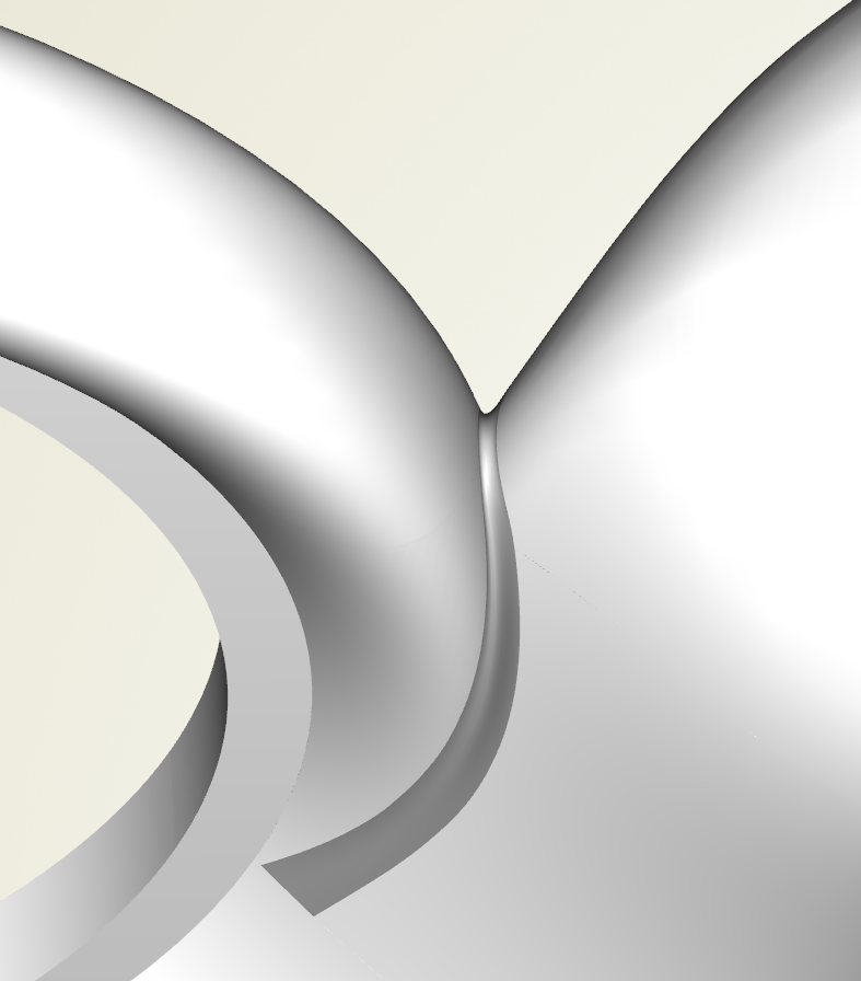

Jörg 29 Report post Posted July 18, 2013 Hi together, Please find attached a quick example for a volute tongue. I extracted this special modeling part from the complete volute designs for a better understanding. CheersJoerg PS: Instead of having a constant factor for the fillet, you can add a custom function for the factor of the fillet surface (and set it at the curve engine) so that the tongue surface has more degrees of freedom.volutefillet.fdb 1 Share this post Link to post Share on other sites

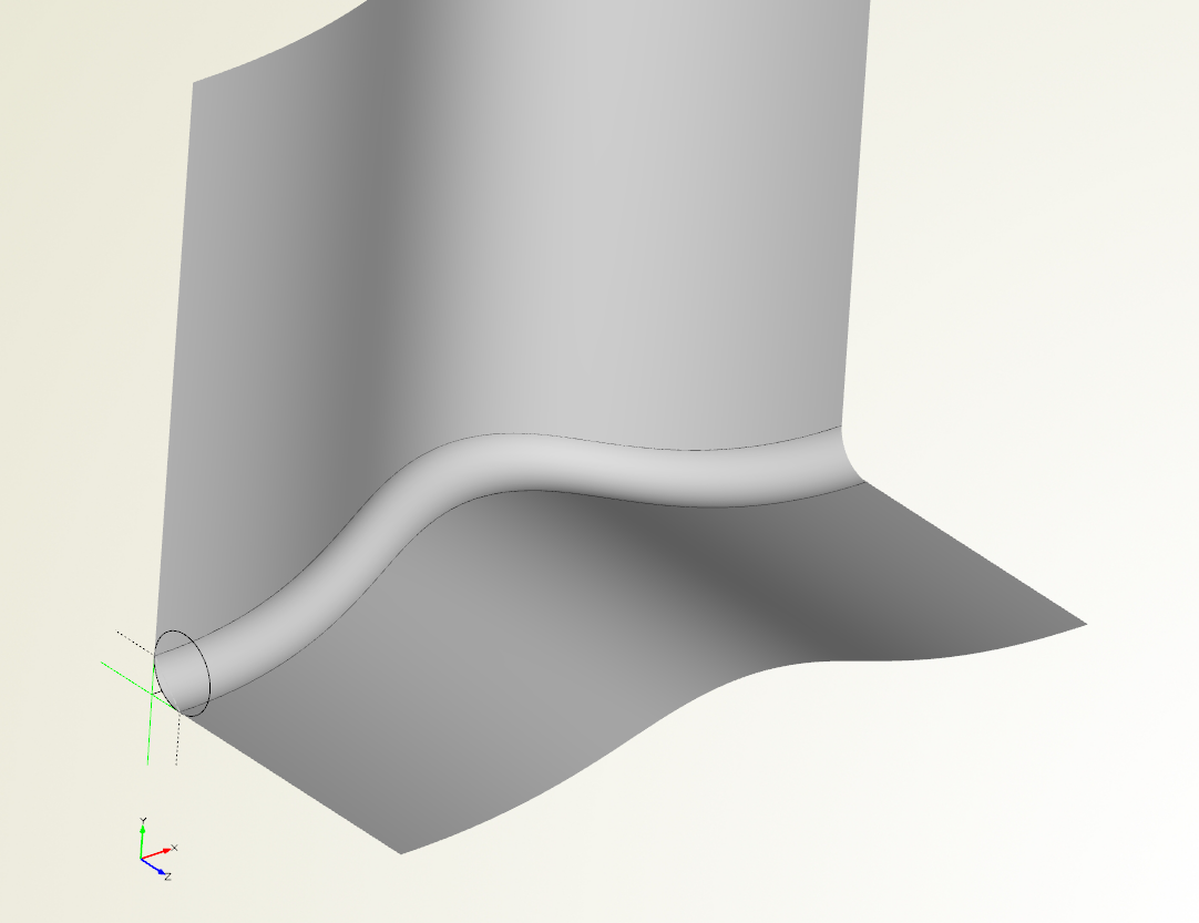

Jörg 29 Report post Posted May 3, 2016 Here is an example that was made by using the breps objects in CAESES. This is one of our standard approaches to model robust fillets for variable geometries. Share this post Link to post Share on other sites

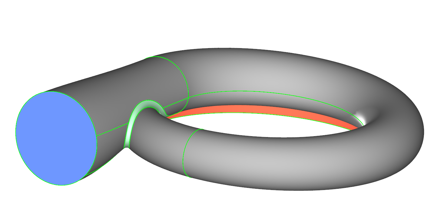

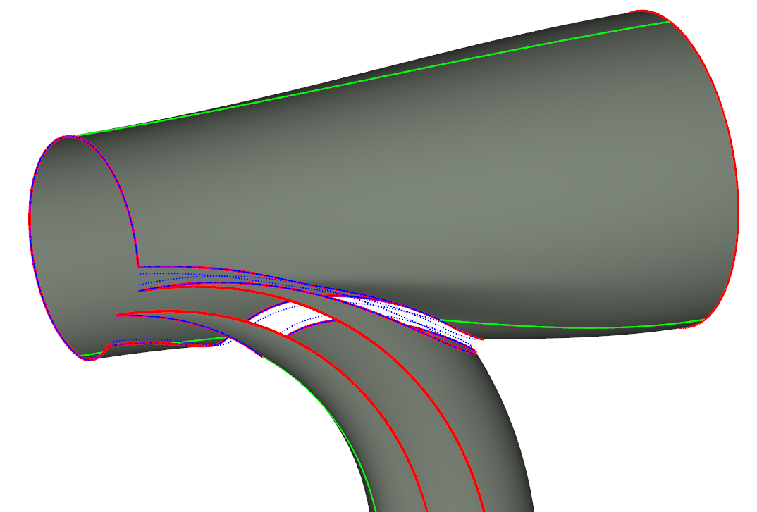

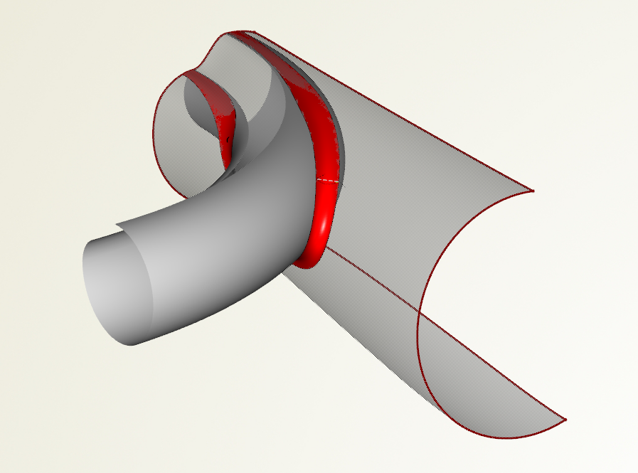

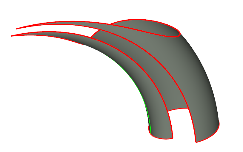

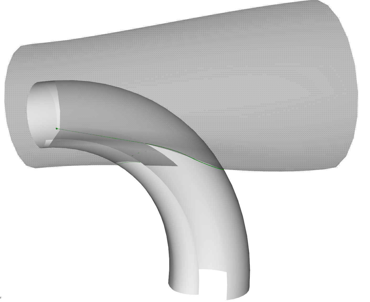

Mr. Carsten Fuetterer 9 Report post Posted July 17, 2017 Hi Marta, attached is an example how you can model the tongue area. Basically we want to trim the volute and the outlet surface in order to have space for a fillet surface. To do this we follow these steps for each part: 1. create intersectioncurve e.g. volute and offsetsurface of outlet2. modify the domaincurve of the intersectioncurve. create also an offsetcurve of the new domaincurve3. create surfacecurve from new domaincurve and a surfacecurve from the offsetcurve, which will be tangent edge for the fillet surfaces4. create a subsurface from the new surfacecurve5. put the subsurface into a brep After you did thtis with both parts it should look like this: Now you can use the edges and tangent edges to create the fillet surface with a meta surface: The final results can look like: best regards Carsten volutecompressor_Training.fdb Share this post Link to post Share on other sites

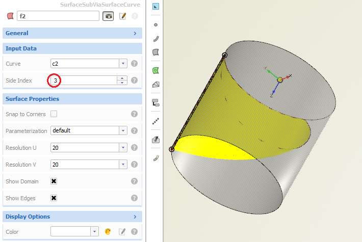

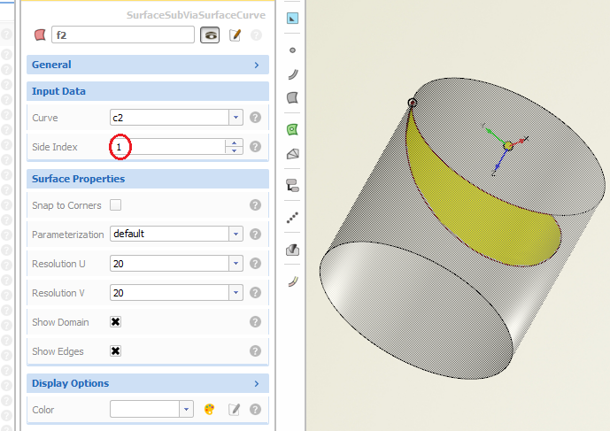

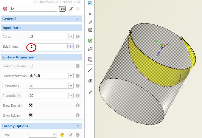

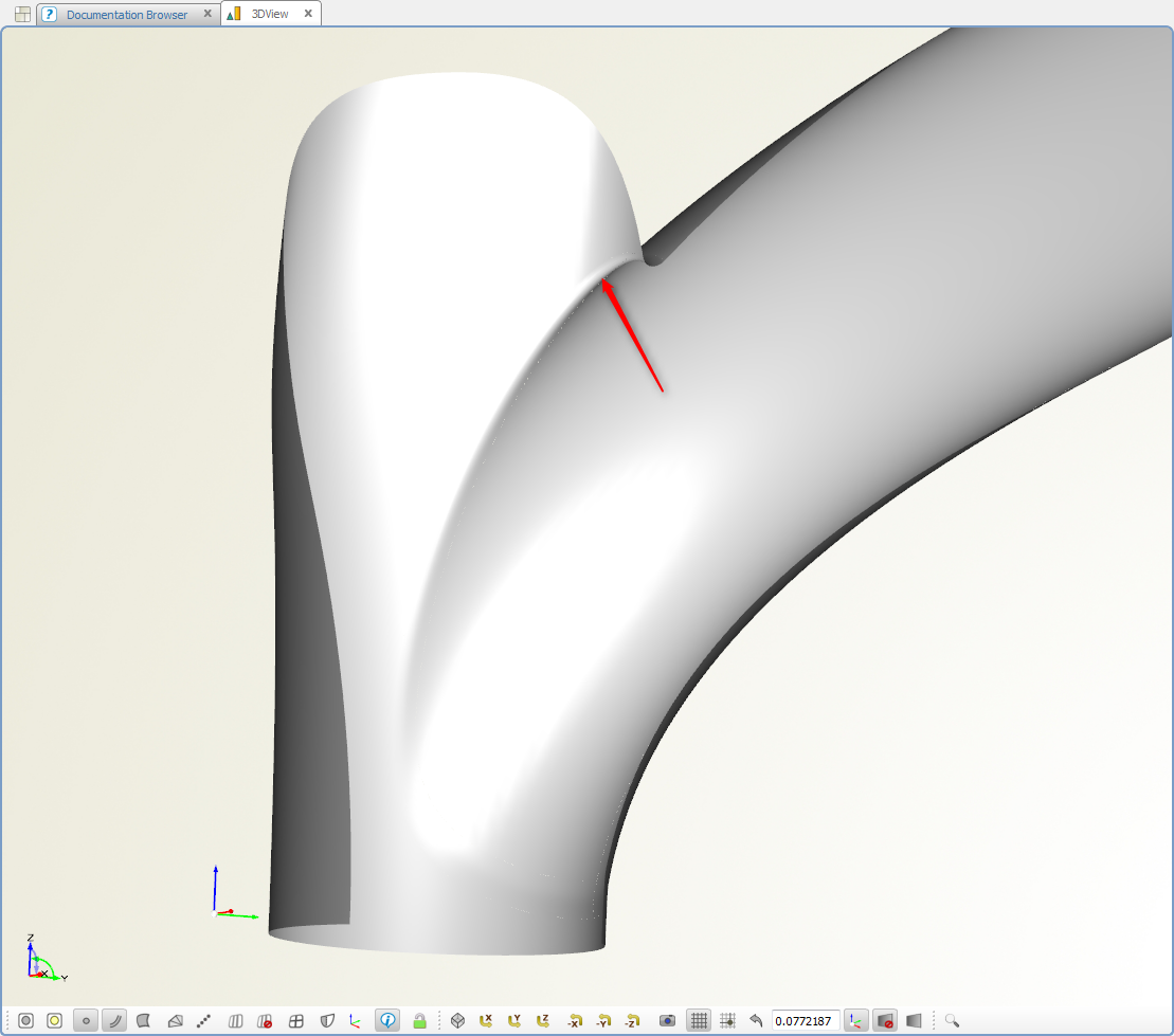

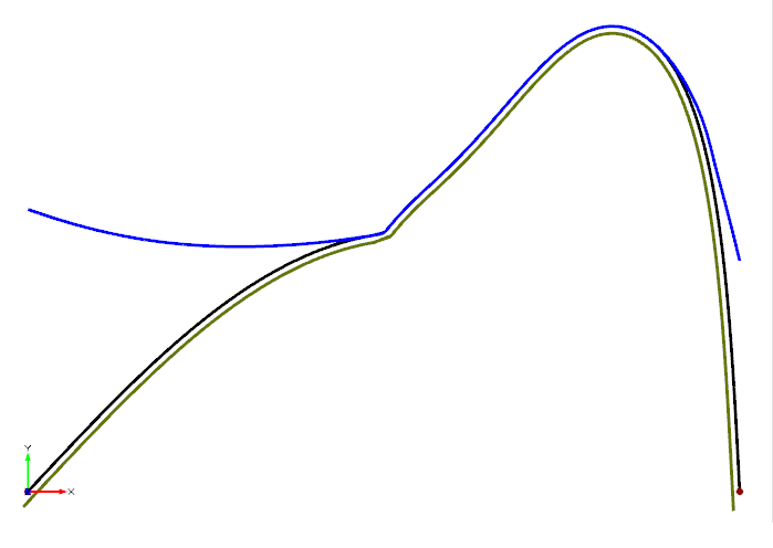

Mr. Vahid Jafari 0 Report post Posted March 21, 2019 Hey together, I want to create a fillet between the spiral casing and the exit cone, but when it comes to creating surface curve and subsurface, I'm getting several problem. One of them is that Caeses doesn't recognize the correct subspace, when I want to create one. Here's a simple example. Attached you can see that with the side index "1" the intersection part is captured , which has to be deleted. The complementary of this part is the correct part, which has to be kept as my subsurface. But as you can see here , there is no way to get this part by changing the side index from 1 to 4. Here's the domain curve as well . Any Idea or suggestion? Best,Vahid Share this post Link to post Share on other sites
