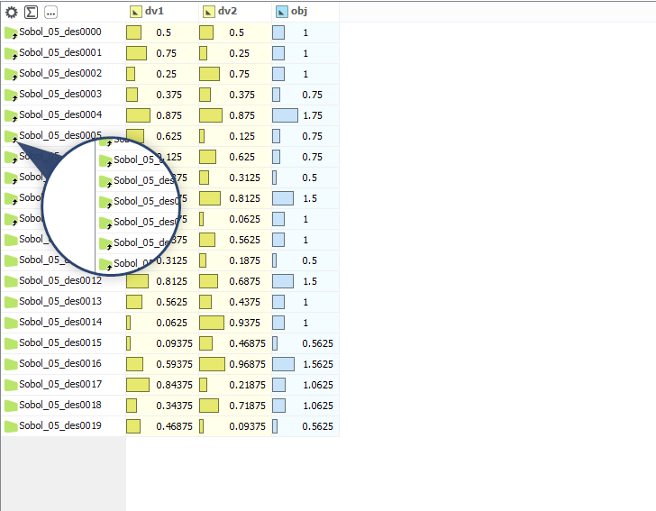

Yeah you are right, maybe I was a bit too fast with my reply. Sorry for confusing you. Indeed, the number needs to be the same for the Dakota LHS case, to make use of the result pool - which then does not result in what you need. I have been thinking of e.g. our Sobol algorithm which works as described before. The attachment shows this behavior for the Sobol run (run with 10 designs, and again with 20 where the first 10 are recycled - indicated by a different icon). post-8-0-76475400-1538656005_thumb.png
