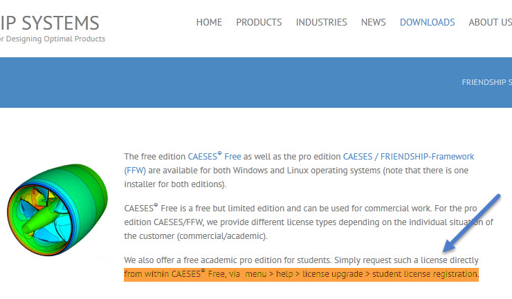

If you are enrolled, let us have a copy of your certificate and we will supply a full license for the duration of your study. Please follow the instructions below

I have followed the directions you have posted. I have another question. In order to perform the optimization on my propeller, is it necessary to integrate an external CFD software with CAESES or does CAESES alone have the ability to perform the optimization. I am mostly interested in the obtaining the thrust outputted by my surface piercing propeller as well as the efficiency of the propeller at varying RPMs. I do not have a CFD software on the same computer as CAESES, so if a CFD software is necessary, my next question is will I be able to transfer my CAESES license to a school computer that has ANSYS FLUENT?

Indeed, you need a tool to assess the quality of your current design to start an optimization. We will provide you a web float license, which will allow you to run CAESES on any machine that is connected to the internet. We will email you soon.
