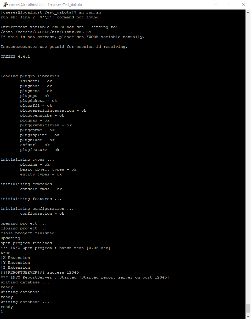

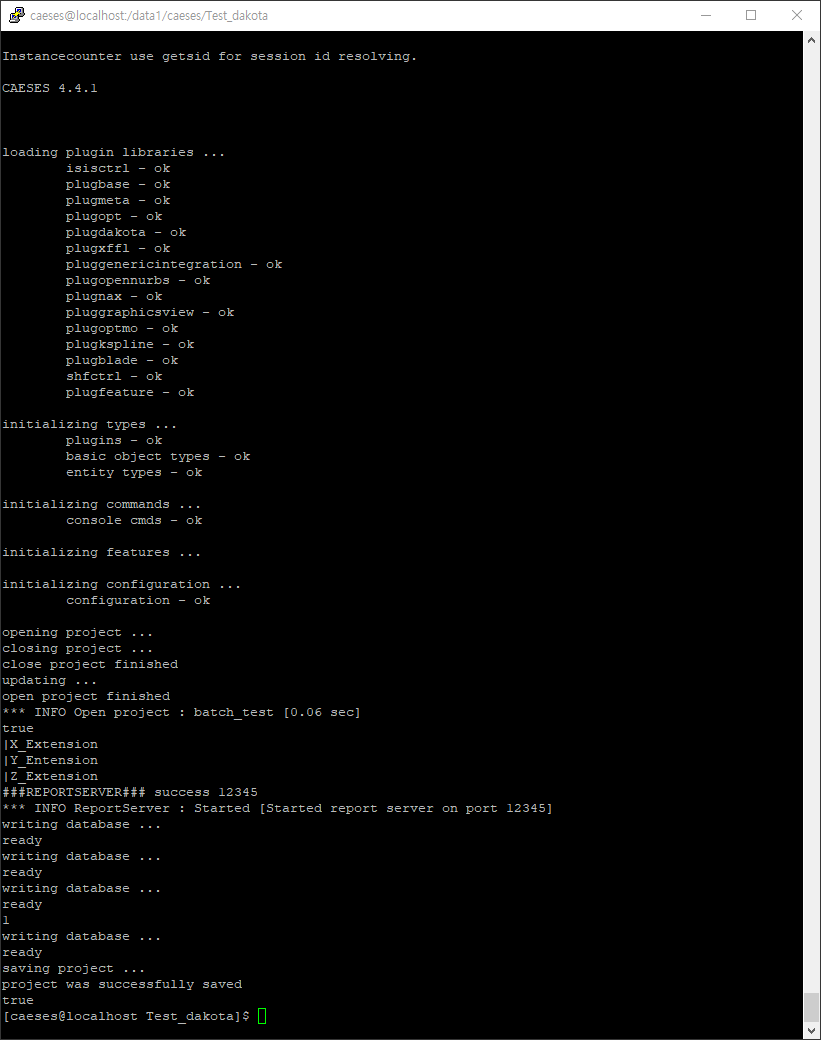

Mr. Kim Moo Sung 0 Report post Posted March 27, 2019 Hi i have confirmed that it works well on winodws and i ran "run.sh"(attached file) on linux(centOS6) but... it did not work.(image1,2) what can i do more...? thanks best regardsMooSungbatch_test_WithDAKOTA.zip Share this post Link to post Share on other sites

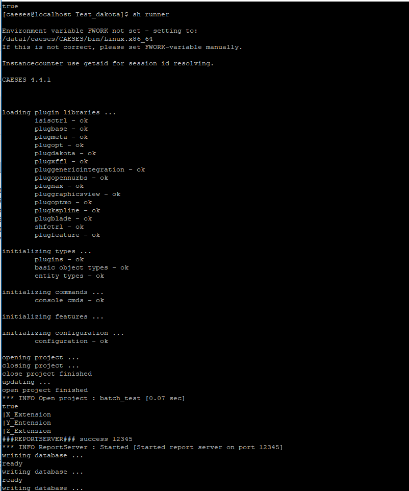

Mr. Heinrich von Zadow 12 Report post Posted March 27, 2019 Dear Kim, try simply recreating your shell script under Linux or refer to this post for a more detailed explanation:https://askubuntu.com/questions/304999/not-able-to-execute-a-sh-file-bin-bashm-bad-interpreter Also the attached script should work for you... Best regards,Heinrichrunner.zip Share this post Link to post Share on other sites

Mr. Heinrich von Zadow 12 Report post Posted April 16, 2019 Hi MooSung, all right, that is the latest you can currently have.Could you please give a few more information on what is shown on the screenshots you have attached? I can't see anything wrong with your script. Maybe, try without -x after shebang and make sure you have all paths correct both, in the fsc and the sh file. Have you checked the CAESES Documentation browser under tutorials/learn more/batch mode? Cheers,Heinrich Share this post Link to post Share on other sites
