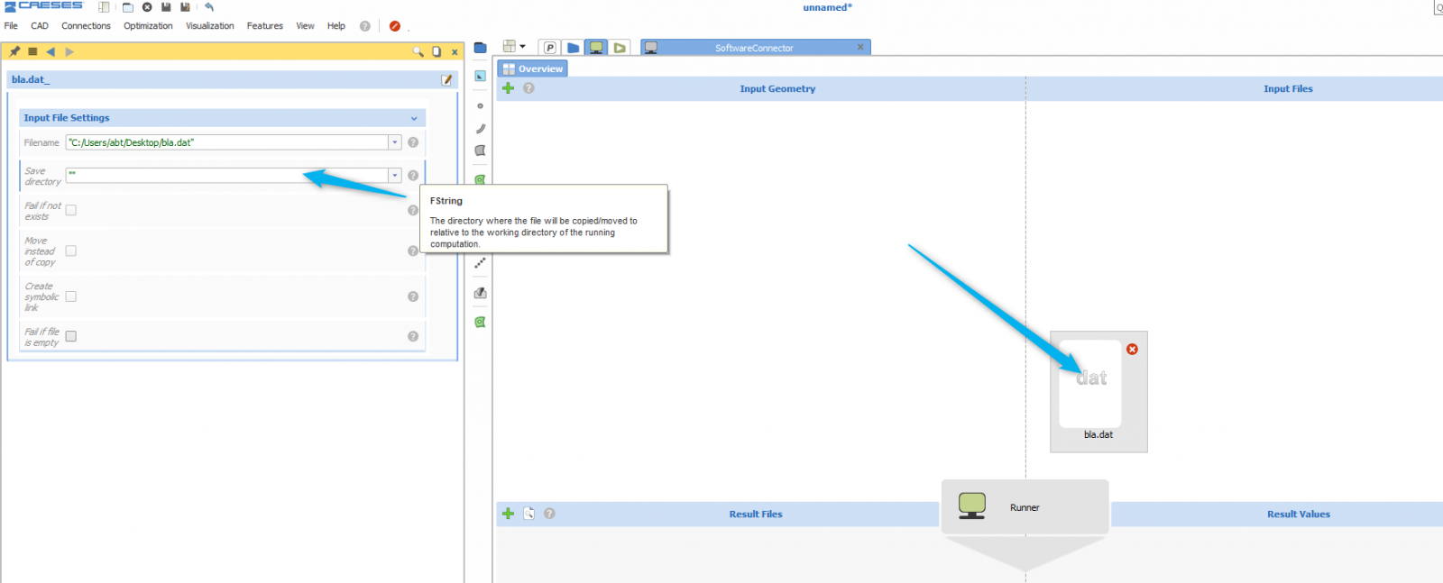

Mr. Claus Abt 14 Report post Posted March 27, 2019 HI Carola,I am not completely sure which path you want to set in the script. If you are using a software connector to run Ansys there is an option to define relative paths at the input files directly, see below.CheersClaus Share this post Link to post Share on other sites

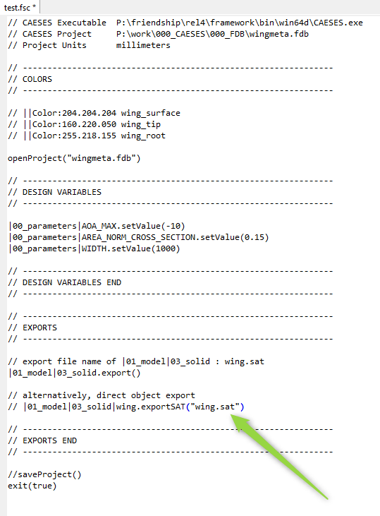

Jörg 29 Report post Posted March 27, 2019 Another note: If you have an export command in your fsc-script, simply use relative names as shown in this example: Share this post Link to post Share on other sites
