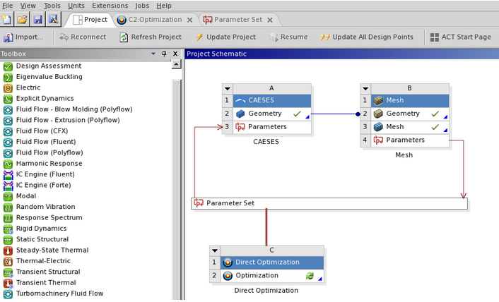

Mr. Hairul Ahmad 0 Report post Posted June 29, 2016 Folks, I am now doing research on optimizing hull designs on preliminary design stage. I am trying to run the CFD by coupling CAESES with ANSYS. I would like to have some help on journals/papers/codings that are much specifically heading towards integrating both software to do a ship/hull optimization only. Really need some advice asap. Thank you. Share this post Link to post Share on other sites
Ceyhan Erdem 15 Report post Posted June 29, 2016 Hi Hairul, Can you be more specific? Are you planning to use the ANSYS workbench platform or the softwares seperately?Which mesher are you planning to use? CheersCeyhan Share this post Link to post Share on other sites
Mr. Hairul Ahmad 0 Report post Posted July 1, 2016 Hi Ceyhan, I am planning to use the the ANSYS workbench platform. Using CAESES as a design viewer for the optimization done in ANSYS. Share this post Link to post Share on other sites
Ceyhan Erdem 15 Report post Posted July 5, 2016 Hi Hairul, I will be providing an example case here as soon as possible. CheersCeyhan Share this post Link to post Share on other sites
Jörg 29 Report post Posted February 2, 2017 Note that there is the possibility to integrate CAESES as an add-in in ANSYS. In this setup, CAESES is run in batch mode in the background. We are working on this, just get in touch with us directly if you are interested in it. Share this post Link to post Share on other sites

Mr. favour ogbenna 0 Report post Posted December 3, 2018 Hi joerg Please I would love to know how this can be done for hull optimization Share this post Link to post Share on other sites
Jörg 29 Report post Posted December 4, 2018 Hi Favour, The latest version of CAESES comes with a detailed tutorial about the ANSYS integration. There is a PDF document plus a HTML help which describes how it works. The app (for adding CAESES to the ANSYS WB) is also shipped with the installation package. CheersJörg Share this post Link to post Share on other sites
