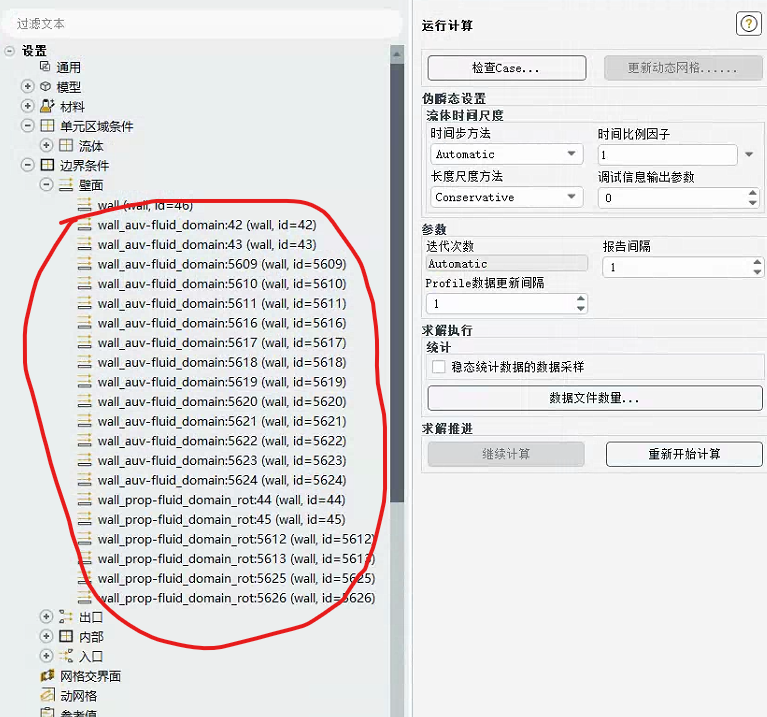

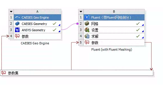

I built a parametric propeller model using Caeses and imported it into the Workbench platform, meshed it with Fluent Meshing, solved it with Fluent, and I had a problem with solving failures.
I named the propeller surface "wall_prop" and selected all the wall_prop named faces in fluent to establish the output as thrust and moment. However, whenever the parameter points are changed and the mesh is updated, the original name will become wall_prop_1, wall_prop_2...... the original name will disappear, and the output torque and force will not automatically select the new name, resulting in the calculated thrust and torque being wrong or the software directly reporting an error.

Hi Ceyhan Erdem,
I connected the parameterized Caeses propeller model with Workbench via Workbench's ACT plugin. Prior to this, I had already used different colors to identify the boundary conditions in Caeses, including inlet, outlet, wall, wall_prop, etc. Fluent meshing and fluent have no problem with the recognition of boundary conditions. In fluent, wall_prop becomes a name prefixed with "wall_prop" and a number as a suffix, for example: wall_prop20, wall_prop4003, and so on.
The problem is that every time I update a new design point and update the grid, the suffix numbers of these names change, and this change seems to be irregular. Since I set the force and moment of the propeller surface as output parameters in fluent, the original wall_prop name I selected disappeared and the new name was not automatically selected wall_prop.

Yes, I used the correct act app. My version is Ansys 2021R1..The image below shows workbench and the changed wall names in fluent. I wonder if it's a problem with fluent meshing?
