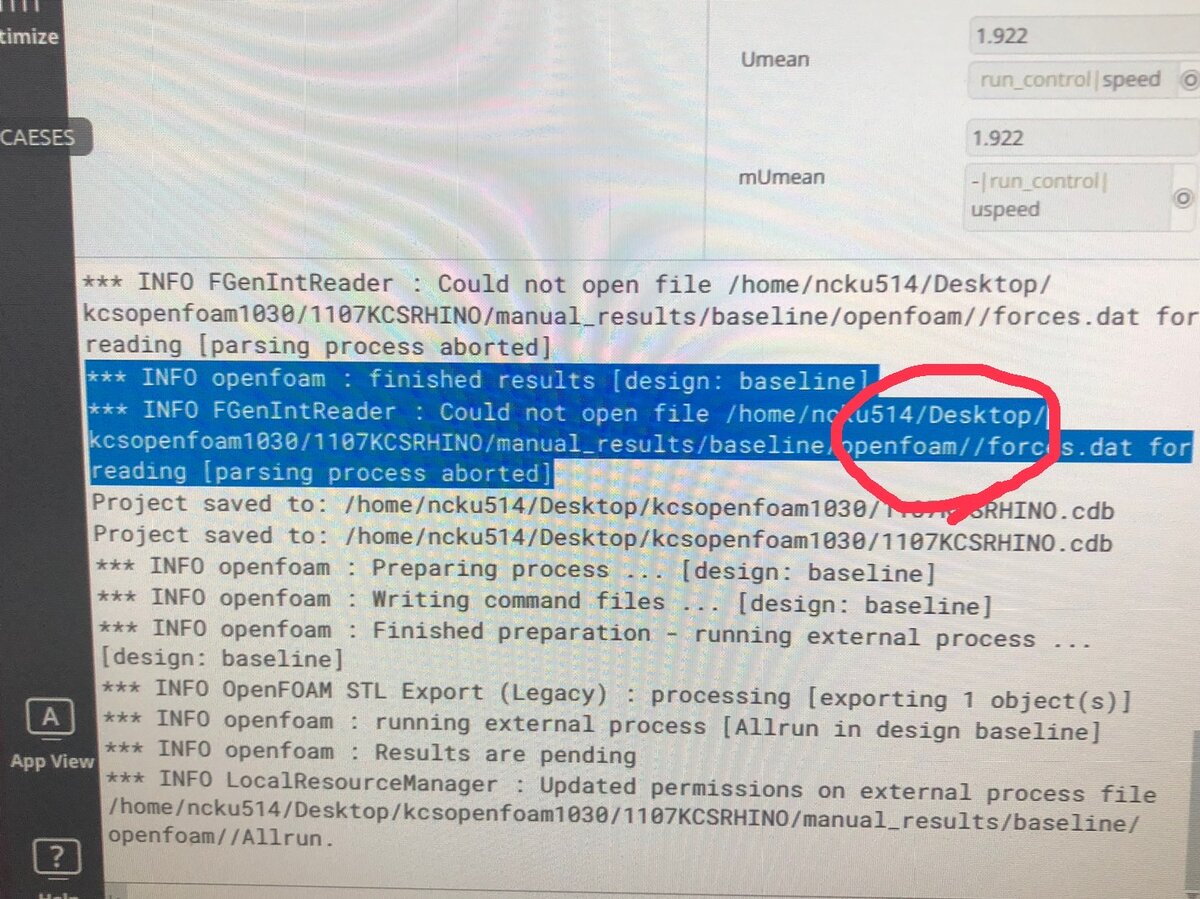

In addition, I would like to ask how the force.dat file cannot be written by caeses after the openfoam execution is completed, and the path generated by it is a bit wrong. How do I need to change it?
As shown in the red circle in the picture
The correct path should be /home/ncku514/Desktop/kcsopenfoam1030/1107KCSRHINO/manual_results/baseline/openfoam/postProcessing/force1/0/force.dat
But he is missing /postProcessing/force1/0/

OpenFOAM is notably complex when it comes to managing numerous processed files. To address this complexity, I've included a screenshot featuring a standard connection input file, geometries, output files, and corresponding values. It's advisable to consistently employ relative paths by utilizing the subfolder option, as illustrated in the second screenshot.
