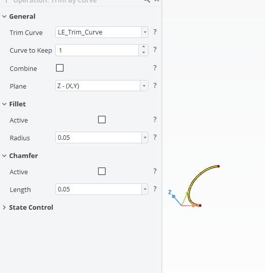

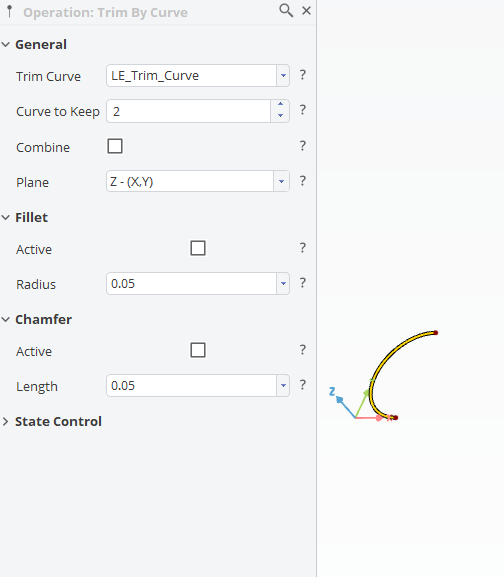

Stanley Gabriel 0 Report post Posted October 17, 2023 Hi Heinrich, Sorry for the confusion and adding something more. I have generated my section with the origin at a different point than I intended. Instead, keeping everything else the same, the curves and everything, I need to only translate my coordinate system. The next one is in the operation trim by curve, I only want a curve that is towards the left hand side. But depending on a design variable I have, the curvature is changing based on "curve to keep". Is there a way to only preserve the left side of the curve always. Regards, Stan Share this post Link to post Share on other sites
Mr. Heinrich von Zadow 9 Report post Posted October 17, 2023 Hi Stanley, there will probably be a robust way to trim consistently but it is a bit hard to suggest without looking at the project. Maybe you can attach a simplified project to show the problem? About the translation: there is also an option to add a transformation as a curve operation... I also recommend you take the time to take a closer look at some of the samples and tutorials to get up to speed. Cheers, Heinrich Share this post Link to post Share on other sites
