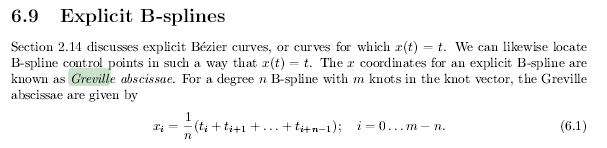

In principle you have to be aware if you are using f(t) or f(x(t)). If you are mapping x=t you can speed up your function. This is possible by using Greville spaced bspline points, see picture below
I found this excerpt on https://syllabus.byu.edu/view/SnfjQFxAdIyY.html#scheduleContainer chapter 6 on bsplines. There are more sources if you search the internet.
