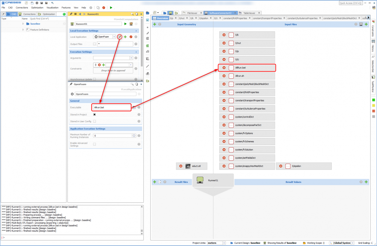

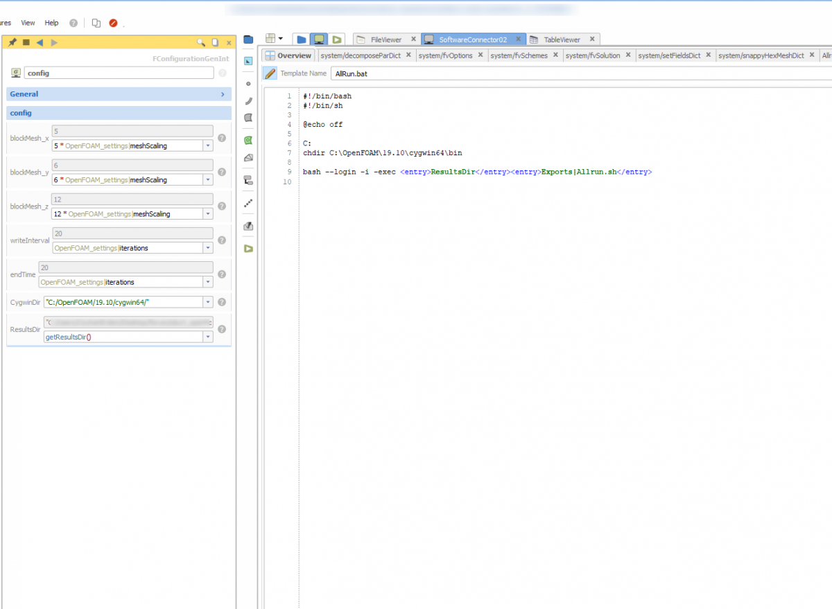

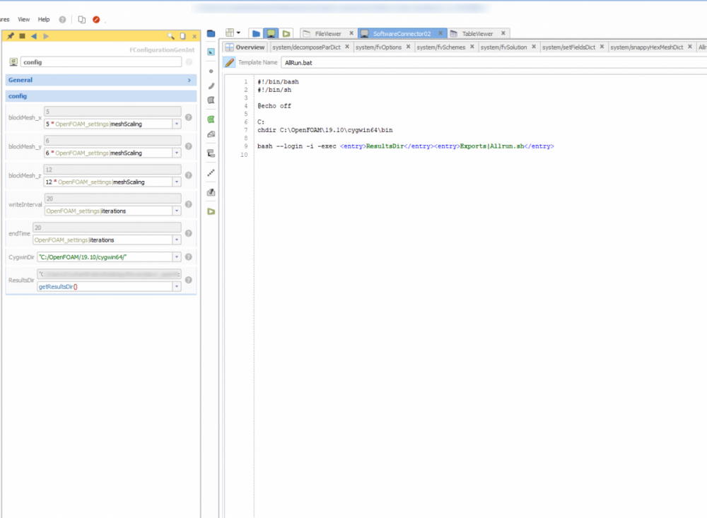

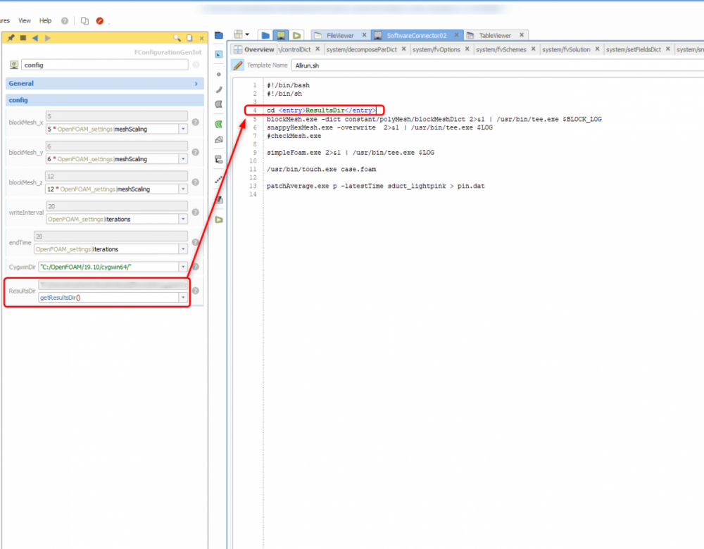

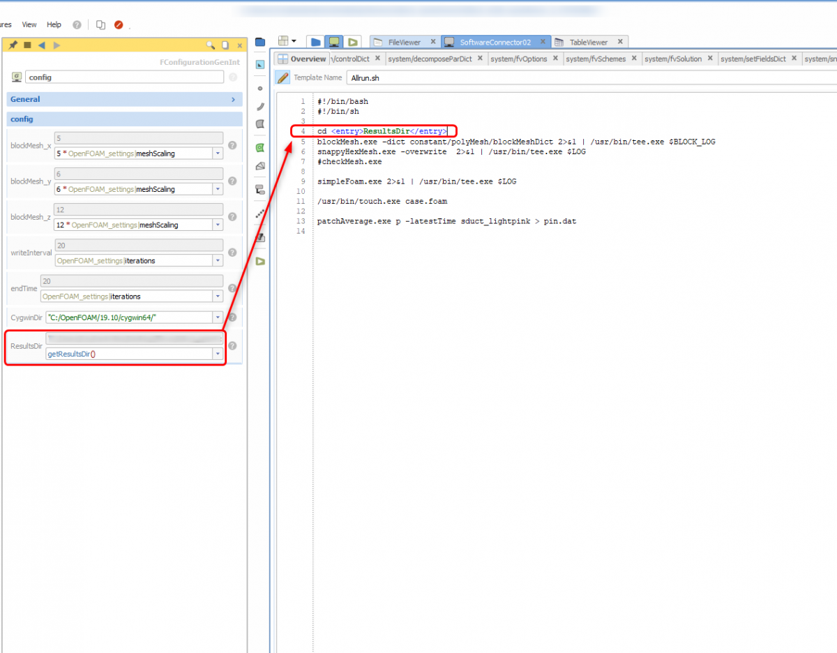

Hi Mlysyshyn,
Please find attached the modified version.
Some modifications I have performed;
1) Within the Runner for the "Local Application" I have selected the AllRun.bat which I have created. Please note that I am not using any arguments.
2) The RunAll.bat executable includes commands within the "C:\OpenFOAM\19.10\cygwin64\Cygwin.bat" executable (lines 4-9) and the path to my script file which is the AllRun.sh (line 9)
3) Finally made a little modification to the script file.
The final configuration seems to be working but didn't pay attention to the OpenFoam setup.
Ceyhan

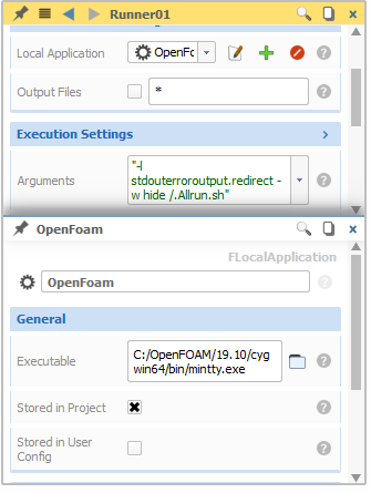

I have tried new configurations, but it still does not work. I am attaching the output file. Any chance there is something wrong with my OpenFOAM or Cygwin?
And also is it better to use another .bat file to call the bash application than setting minnty.exe as executable directly like it was shown during one of the webinars?
Thanks in advance.
