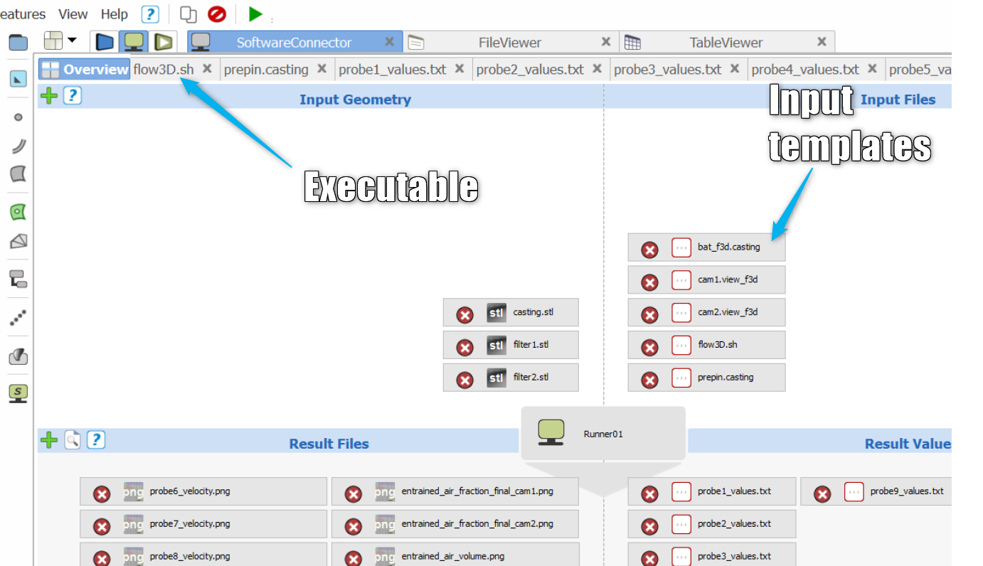

Mr. Carsten Fuetterer 9 Report post Posted July 9, 2019 Hi Farzam, find attached a sample project with a software connector. Let me know if you have any questions. best regardsCarstentumbler_clean.fdb Share this post Link to post Share on other sites

Mr. Claus Abt 14 Report post Posted July 17, 2019 Yes, that is possible. Just take a control file for Flow3D into the input quadrant of the softwareConnector, double click and insert Entries for the parameters you want to change. Fill the entries with DesignVariables etc...CheersClaus WRT the executable: how do you start Flow3D if not running the executable? Share this post Link to post Share on other sites
