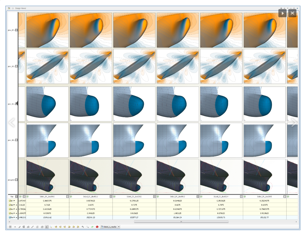

Ms. Daphne Xin 0 Report post Posted July 5, 2019 Can anyone kindly provide me guidance or step by step to do the optimization based on bulbous bow exactly like shown in the picture?Thank you for helps.by Daphne :) Share this post Link to post Share on other sites
Mr. Daehwan Park 1 Report post Posted July 5, 2019 Dear Daphne The form variation shown in the attached thumbnails above was done from a fully parametric model. In order to get step by step idea for hull form creation in parametric way you could get information from the tutorials embeded in CAESES. Please go to Documentation Browser > Tutorials > Hull Design. For bulbous bow modeling, it would be good to refer the article below. https://www.caeses.com/forum/index.php?/topic/315-bulbous-bow-shape-analysis/ Best regardsDaehwan Share this post Link to post Share on other sites

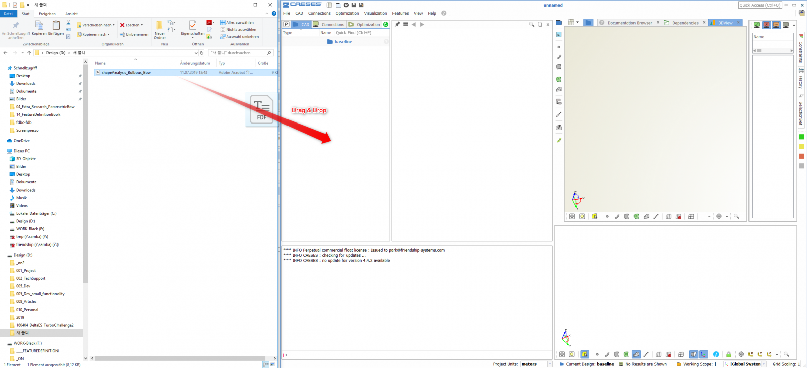

Ms. Daphne Xin 0 Report post Posted July 11, 2019 Hi Mr. Daehwan Thanks for helping meIt refer to the article share by Mr. Daehwan For bulbous bow modeling, it would be good to refer the article below. https://www.caeses.com/forum/index.php?/topic/315-bulbous-bow-shape-analysis/ For the fdf file via this article above which are bulbous bow section and also shape analysis bulbous bowThis is because my computer unable to read in fdf file.Can you guide me the way to import fdf file in caeses software? Or make these fdf file in feature tool Caeses Thank you for your help :) by Daphne Share this post Link to post Share on other sites
Mr. Daehwan Park 1 Report post Posted July 11, 2019 Hi Daphne There are several ways to import the fdf file but here I would like to introduce you the easiest one. Just drag and drop. Cheers,Daehwan Share this post Link to post Share on other sites

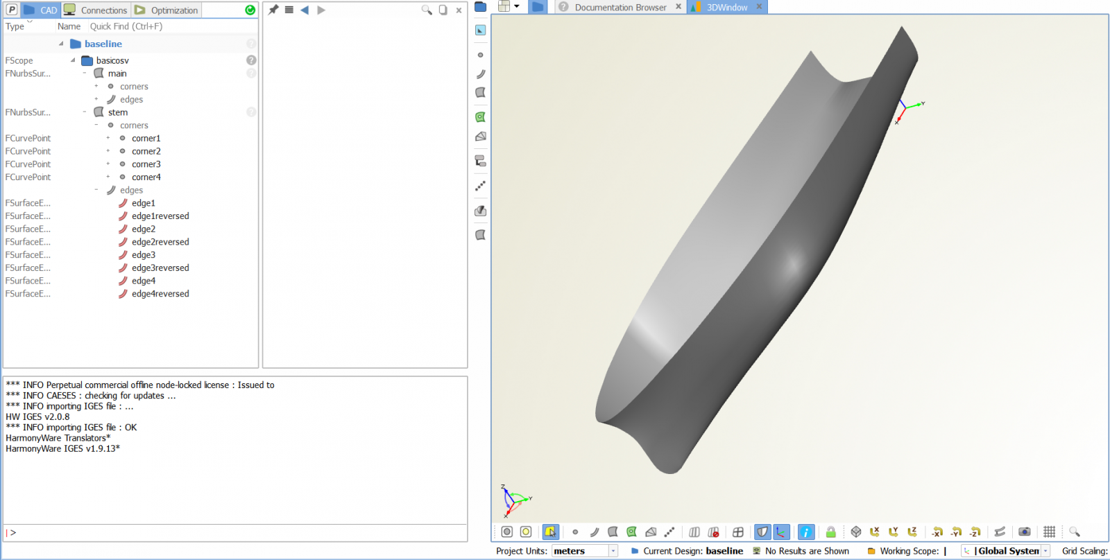

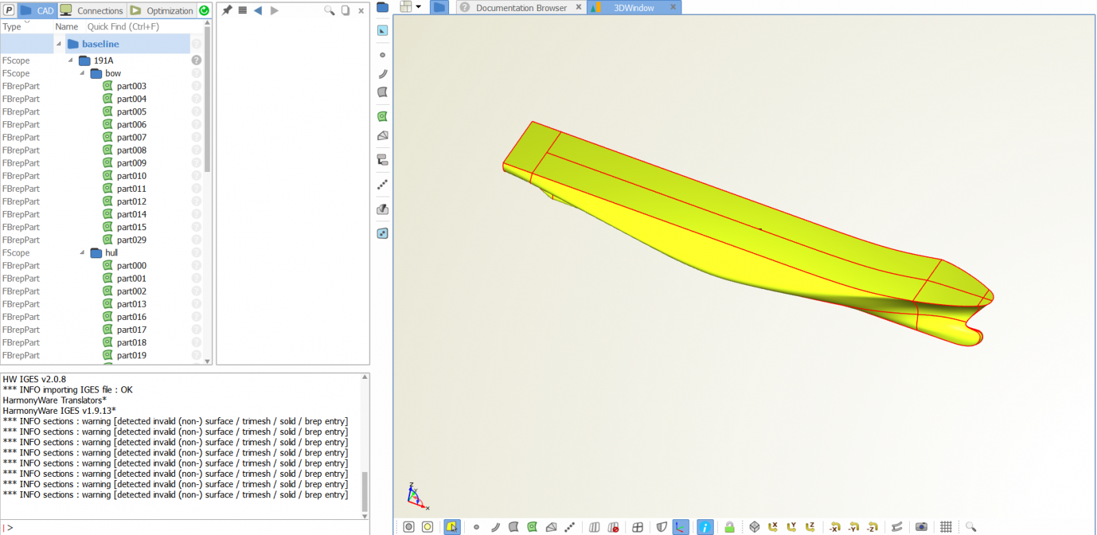

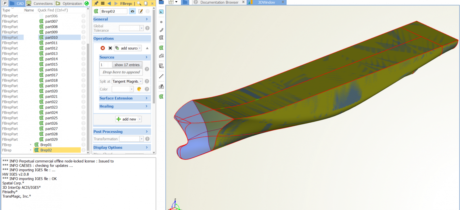

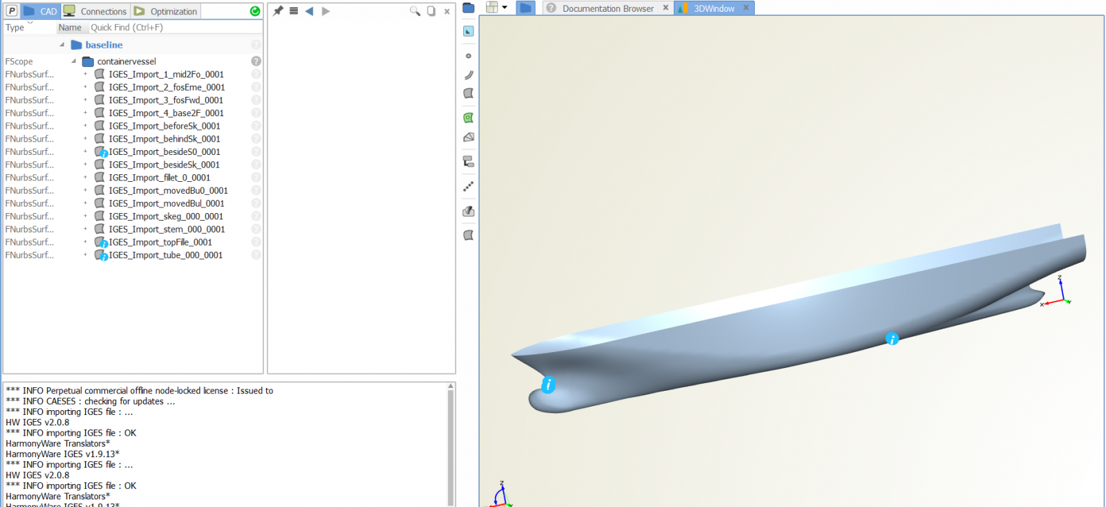

Ms. Daphne Xin 0 Report post Posted July 16, 2019 Hi Mr & Mrs Sorry to interrupt that I have one question Does any efficient way provides to change the import geometry in FBrepPart into FNurbSurface for hydrostatic calculation, hull variation and also lackenbyshift purposes? Share this post Link to post Share on other sites
Mr. Daehwan Park 1 Report post Posted July 16, 2019 Hi Daphne I guess you might have imported iges.All segmental patches of Nurbssurface and FBrepPart should be assembled in one Brep. Then the Brep can be used in Hydrostatic proceedure and all shift variations including lackenbyShift. CheersDaehwan Share this post Link to post Share on other sites
Ms. Daphne Xin 0 Report post Posted July 16, 2019 Hi Mr. Daehwan Thanks for your help Btw, i dunno how to assembled in one Brep, can you guide me the way to do it ? And the one that i show you was imported iges format file. (For example the iges file that used in tutorial "containervesel.iges'') ByDaphne Share this post Link to post Share on other sites
Mr. Daehwan Park 1 Report post Posted July 17, 2019 Hi Daphne 1. Select all surface patches and brepParts.2. During stil selected, create a new brep. Then they are assembled in a one brep. // Daehwan Share this post Link to post Share on other sites
Ms. Daphne Xin 0 Report post Posted July 17, 2019 Hi Mr Daehwan First of all, thank you for helping me in solving problem. However, once i assembled in a one brep, it overlap with old brep parts and i try to delete old brep parts one by one and then whole ship model dissapear. 1. How to solve this problem and i just want to keep the assembled brep one only?2. How to assembled FNurbCurve? ByDaphne Share this post Link to post Share on other sites
Mr. Daehwan Park 1 Report post Posted July 17, 2019 Hi Daphne I guess the OVERLAP is just a matter of visual effect.When you delete an original brepPart, then the Brep will also lose the same source.Just click the scope having the original brepParts and surfaces to shut off. Then the color of the scope will be changed to gray and all the geometry under the scope will be unvisible. // Daehwan Share this post Link to post Share on other sites

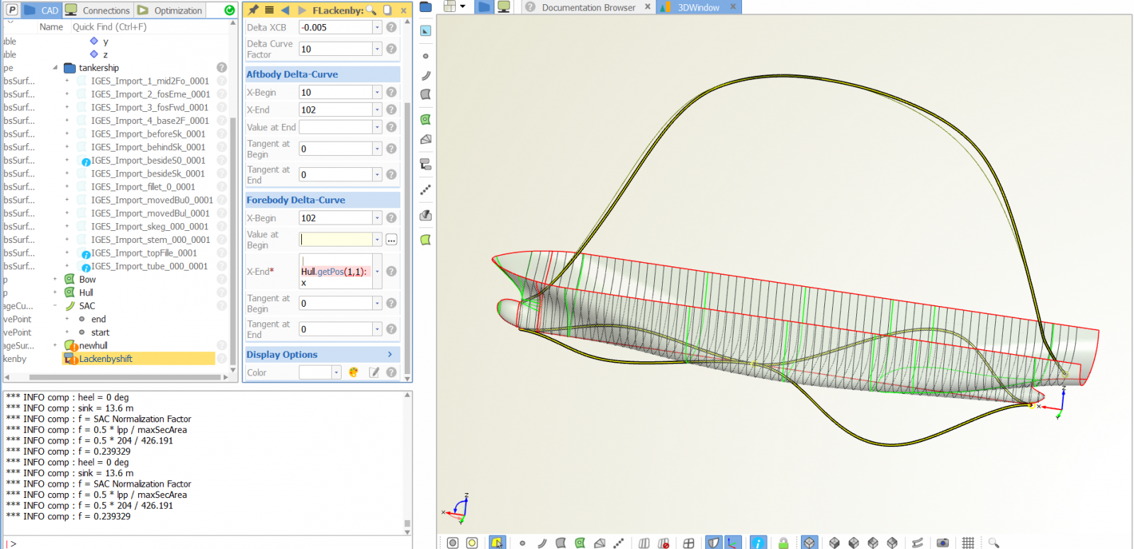

Ms. Daphne Xin 0 Report post Posted July 18, 2019 Hi Mr Daehwan Again, thanks for your help For assembled different NurbSurfaces into a one NurbSurface, I applied the same assembly method like previous brep parts but still unable to assembly into a one NurbSurface. First I select all NurbSurfaces and then i create a new nurbsurface, but in new nurbsurface only one nurbsurface been selected, why does this happened? Can you guide me the way to assembled different NurbSurface into a one NurbSurface for hull variation, hydrostatic calculation and also lackenbyshift purposes? ByDaphne Share this post Link to post Share on other sites

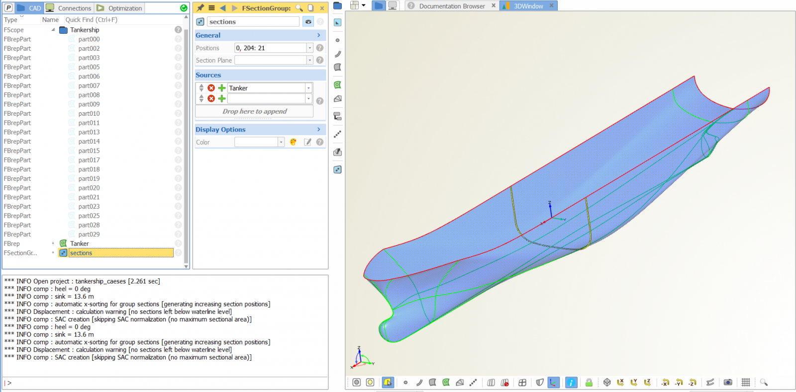

Mr. Daehwan Park 1 Report post Posted July 18, 2019 Hi Daphne NurbsSurface or BSplineSurface does not work for assembling several surfaces. There is a data type SurfaceGroup that works for it. But the SurfaceGroup cannot assemble Surfaces and BrepParts together. In this CASE Brep is the alternative since Brep can assemble Surface and BrepParts in one Brep object. 1. Assemble the surfaces and brepParts in a Brep.2. Create a SectionGroup with the Brep.3. Create a Hydrostatic Calculation4. Create a LackenbyShift using the SAC from the hydrostatics5. Create another Brep in the same way with 1.6. Insert LackenbyShift in the new Brep. This is the proceedure that you want to make. //Daehwan Share this post Link to post Share on other sites
Ms. Daphne Xin 0 Report post Posted July 18, 2019 Hi Mr Daehwan Thanks for helping me. I already assembled all surfaces in a one brep, when i doing hydrostatic calculation in creating section group , the brep i put as source but only one section been carried out. The results of computation all become zero undefined. The way i did hydrostatic calculation followed the tutorial. Mr. can you guide me the way to solve this problem? Thank you By Daphne. Share this post Link to post Share on other sites
Mr. Daehwan Park 1 Report post Posted July 18, 2019 Hi Daphne I guess your model would be scaled by its length and the origin is set in the middle. You need to change the position values suitable to the model. // Daehwan Share this post Link to post Share on other sites

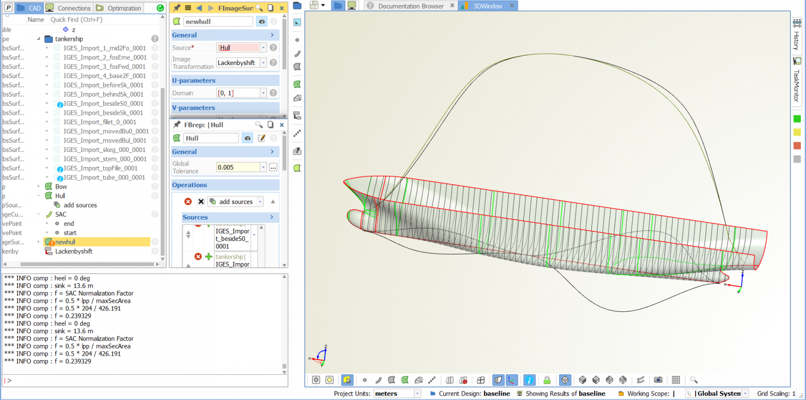

Ms. Daphne Xin 0 Report post Posted July 19, 2019 Hi Mr Daehwan Thanks for helping me 1. I now faced the problem which i cannot drag&drop brep object as source for image curve for new hull, hull variation and also x-end forforebody delta curve (lackenbyshift)Is there any possible way to solve this problem, Mr. Daehwan?. 2. How to re-set the position value for my ship model?Can you guide me the procedure to re-set the position values of my ship model for lackenbyshift purpose? By Daphne Share this post Link to post Share on other sites
Mr. Daehwan Park 1 Report post Posted July 19, 2019 Hi Daphne It seems that you are doing very well and soon the LackenbyShift will work successfully. The ImageSurface "NewHull" can have a surface as its source. In this case, please create another Brep with a certain name to distinguish it as a final hullform for example "FinalHull". And in the Transformation slot in the FinalHull insert the LackenbyShift. Then you will see the shape will be transformed by LackenbyShift. Have a nice weekend! // Daehwan Share this post Link to post Share on other sites

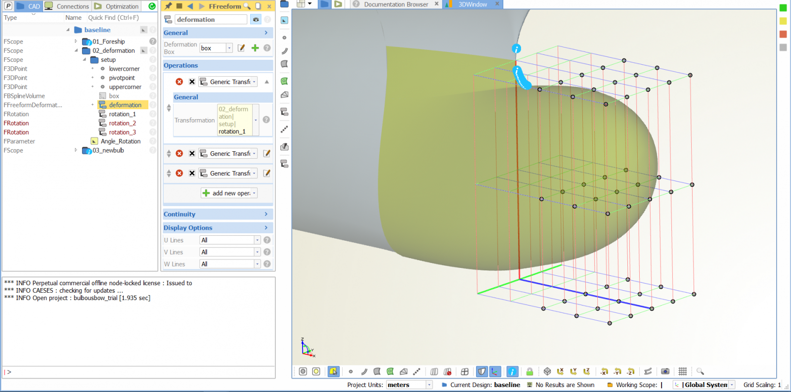

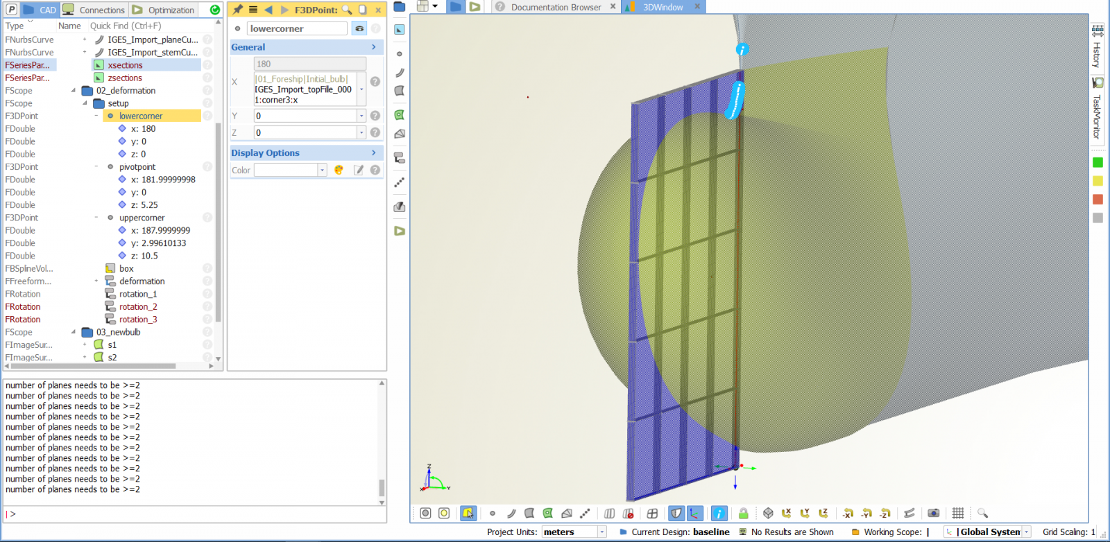

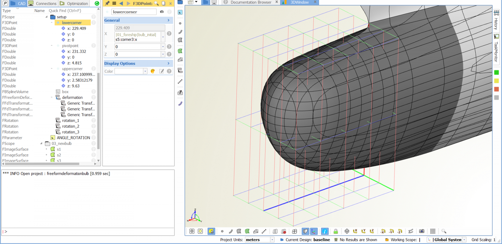

Ms. Daphne Xin 0 Report post Posted July 31, 2019 Hi Mr & Mrs professional Sorry to interrupt everyone again. 1. When I did free form deformation bulb, why the result of bow deformation not same as the tutorial that i practiced, i followed step by step the tutorial freefromdeformation bulbs but fail to figure out the problem. I lack of knowledge about the free form deformation could you provide me some extra knowledge about deformation of bulbous bow 2. Another day i able to solve this problem as shown above but for the rotate deformation fail to do variation angle of rotation of bulbous bow, why this condition happened? ByDaphne Share this post Link to post Share on other sites
