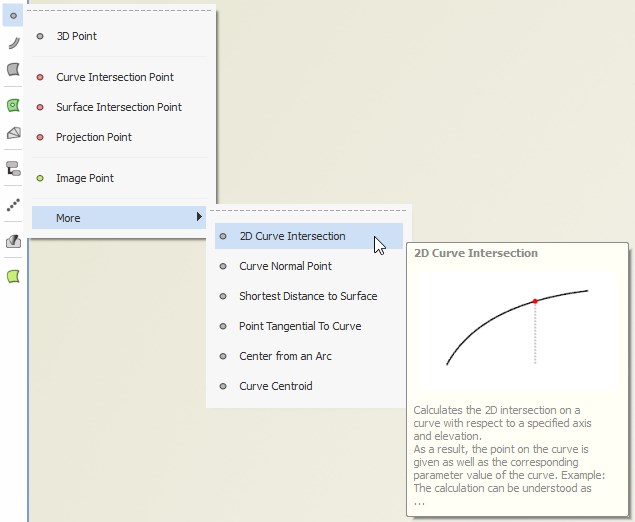

Mr. Ashesh Pradhan 0 Report post Posted June 18, 2019 Hi everyone, I have a drawn an F-spline curve. Now I want the y-coordinate at a particular x-location on the curve. How do I get that point ? I want to draw another curve starting from that point, that's why I need the point on my first curve. Please help. I am beginner in CAESES modelling. Share this post Link to post Share on other sites
Mr. Claus Abt 14 Report post Posted June 18, 2019 You can create a point in the command line by typing "point onFSpline(nameOfFspline.fv(0,xPos))" Share this post Link to post Share on other sites
Jörg 29 Report post Posted June 18, 2019 Hi Ashesh,There is also a ready-to-use point (feature) for it: CheersJörg Share this post Link to post Share on other sites
