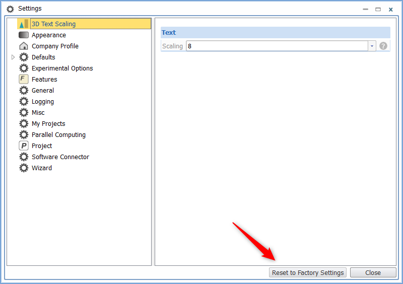

  • Reset CAESES to factory settings. Therefor go to file/settings:

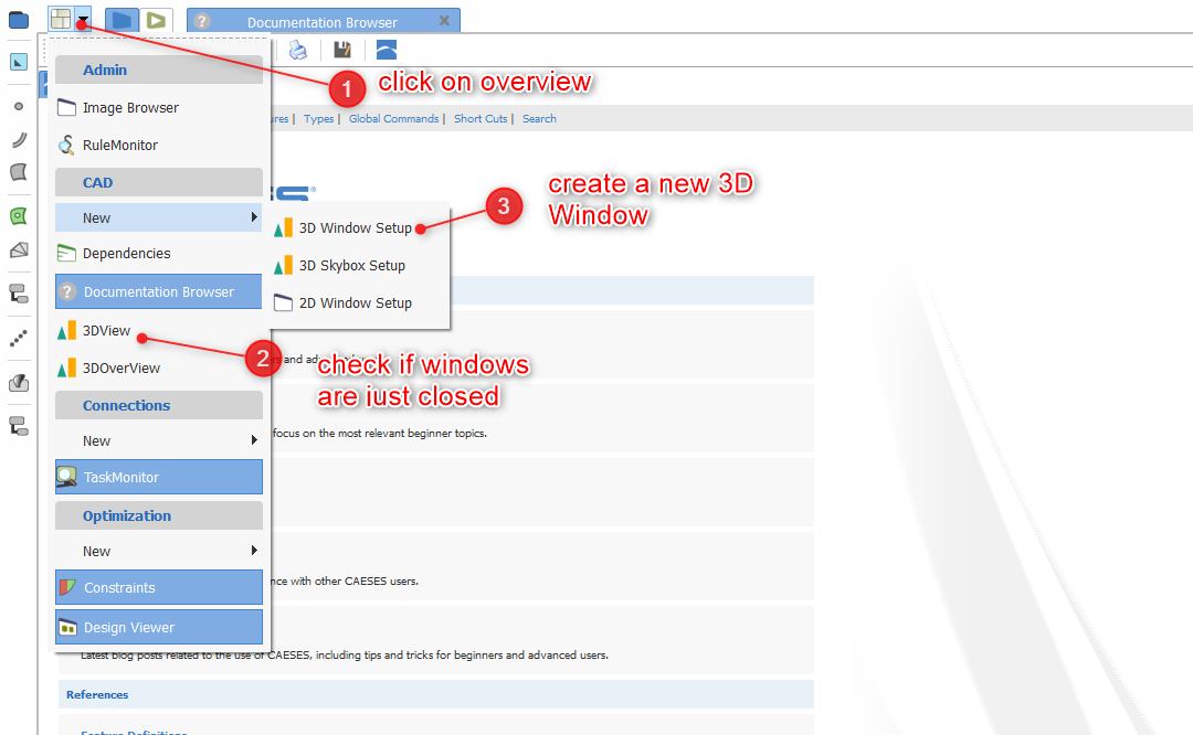

  • you can first look if you just closed it and if you can not find it you can easily create a new one:

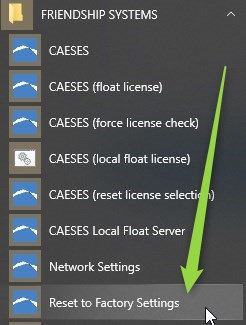

In some special cases we observed that only the CAESES restart works, using the "reset to factory settings" menu entry: post-8-0-94195000-1557320332_thumb.jpg
