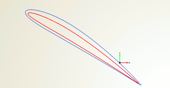

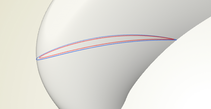

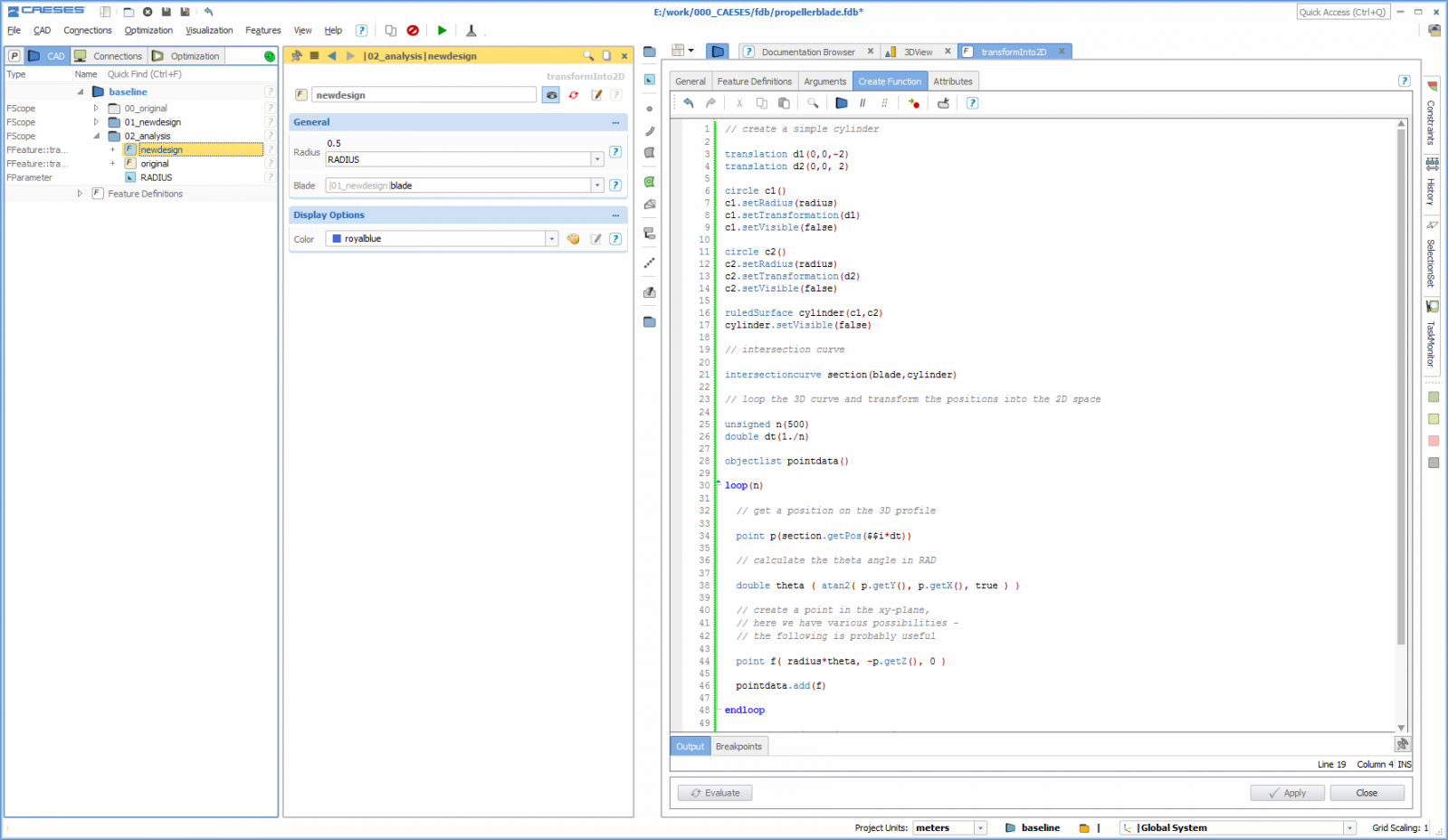

Here is the project file and some pictures that were used in this post. In this short blog post we explain how to compare the 2D sections of two different blades, at a specific radius location.
