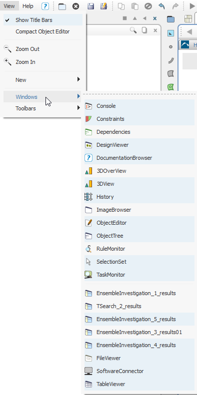

If your projects gets opened veeery slowly, then one reason for this could be hidden result tables resulttables.png They have been closed, but they are not directly visible in the GUI, only through the menu.
We've seen projects with huge sets of hidden result tables. In future CAESES versions, you will get asked whether you want to close or (this is new!) remove a result table. This will hopefully avoid that one simply closes and forget about a result table. We'll see...

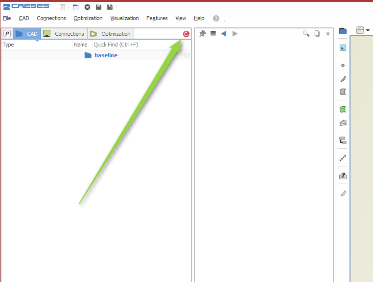

I've just noticed that you entered a trimesh into a brep. This is something you should definitely avoid! It takes all single triangles and creates single surface patches which means for many triangles this takes a lot of time. It is a very special functionality - and, seeing your problem, I think we should not allow this anymore (we'll discuss it in the team). It is useful for only a tiny subset of problems.
See the attachment. Before you open your file, deactivate the update process. Then you are able to open your project and e.g. remove the last BRep operation, or set the BRep to invisible etc. Then activate it again to generate the model.
