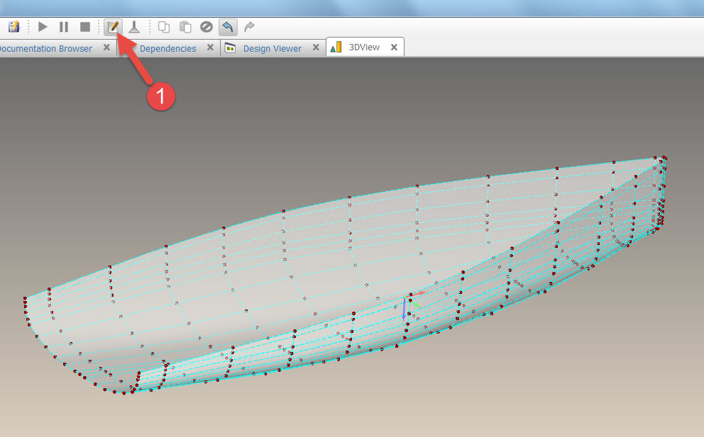

Mr. Claus Abt 14 Report post Posted November 20, 2014 HI Britt,First of all, you don't need to switch to another program. You can see and edit the net of pointbased surfaces (and curves) also in CAESES. Select the surface(s) you want to edit and set them into edit mode, see picture. Secondly, I am not quite sure why the first imageSurface's export keeps the multiplicities. Normally Images will be exported as interpolated nurbs surfaces of the rendering positions that you can define yourself, i.e. the U and V resolution. For surfaces with discontinuities I propose to split them into separate images and export them. E.g. transition from flat to curved or maybe the stem and the flat part of the entrance.We will dig a little deeper and see what we can do. Best regardsClaus Share this post Link to post Share on other sites
