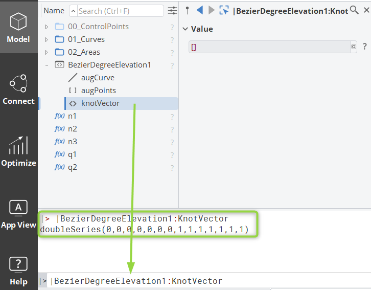

Hi Thomas,
Your code seems to work fine and sets the knot vector correctly for the b-spline curve.
However, the display field of double series attributes in feature definitions has a small bug. So to see the values of the knotVector doubleseries you can drag and drop the "knotVector" into the console field and press enter.
Cheers,
Hedi

Hi Heidi,
Thanks for your response.
The knotVector that shows in the curve inspection window is not the same as the knotVector that prints to the console.
The vector I construct in the script has 14 values, while the one populated in the inspection window seems to have 10 values?
Ah as soon as I typed that I found the bug!
Amazing what a bit of sleep will do.
I had neglected to cast the first and last points in the entityGroup of points to an FPoint type.
Although they rendered on screen as points it seems like the spline curve was not actually reading them as points, which was maybe interfering with the allowable length of the knot vector?Weird...
Anyway, Thank you very much for your help!
