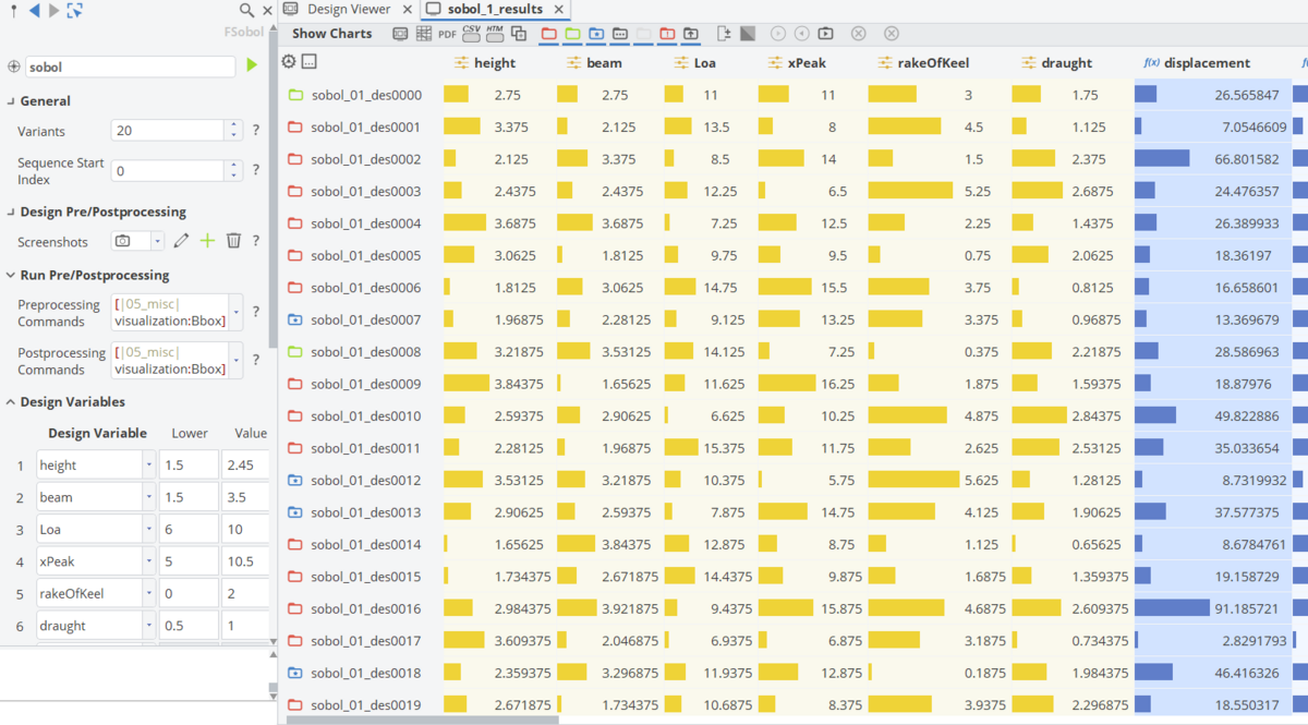

CJ Coll 0 Report post Posted February 18, 2024 If I have run the initial simulation through CAESES and now I want to run it through the Sobol analysis but I only want to analyse, say, designs 0,8,11,15,19. How can I specify this before CAESES runs all 20 variants through StarCCM, which would take far too long? Share this post Link to post Share on other sites

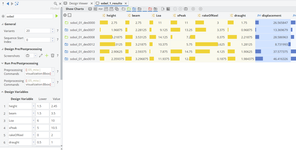

CJ Coll 0 Report post Posted February 19, 2024 For example, when I run the Sobol without my CFD evaluations, it gives me 20 variants but a lot of them do not meet my constraints. Then when I hide violated designs, it narrows down to 6 designs, these are the ones I would like to run through CFD. Is there a way to exclude the violated designs from the CFD evaluations, as running 20 sims will take significantly more than 6. Share this post Link to post Share on other sites

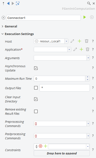

Mr. Heinrich von Zadow 12 Report post Posted February 19, 2024 Hi CJ, you can set constraints to your computation. If violated, the computation will not be executed. Of course, this only works if the constraint can actually be evaluated before the CFD ran. Cheers, Heinrich Share this post Link to post Share on other sites
