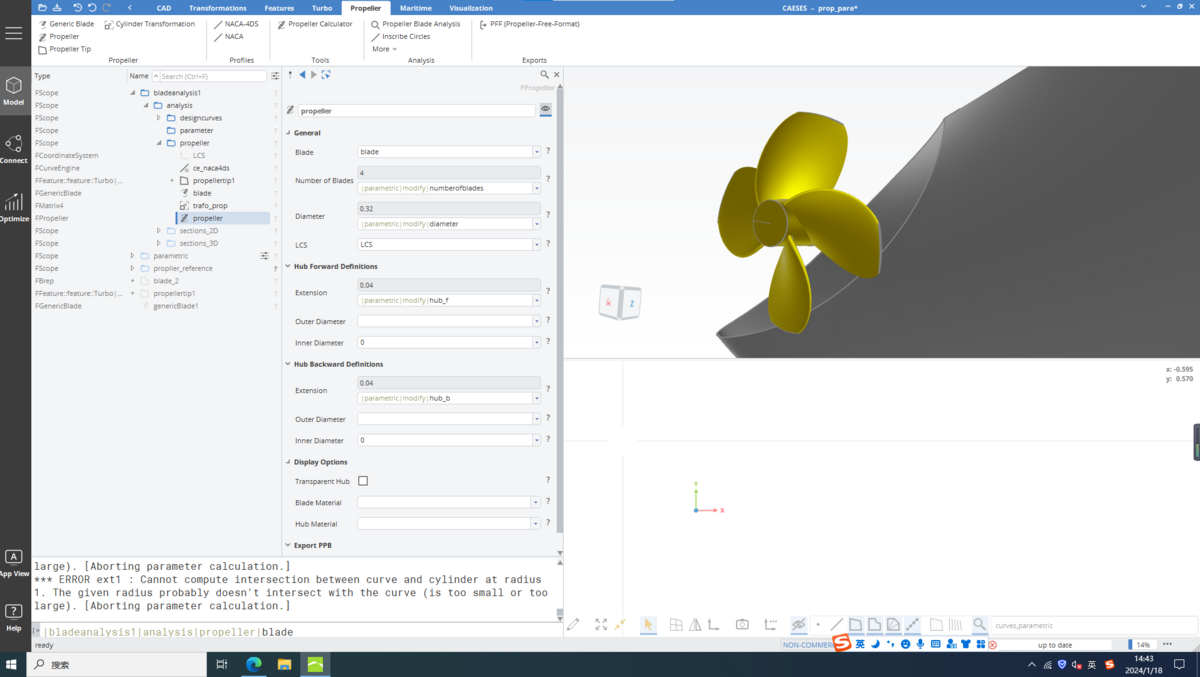

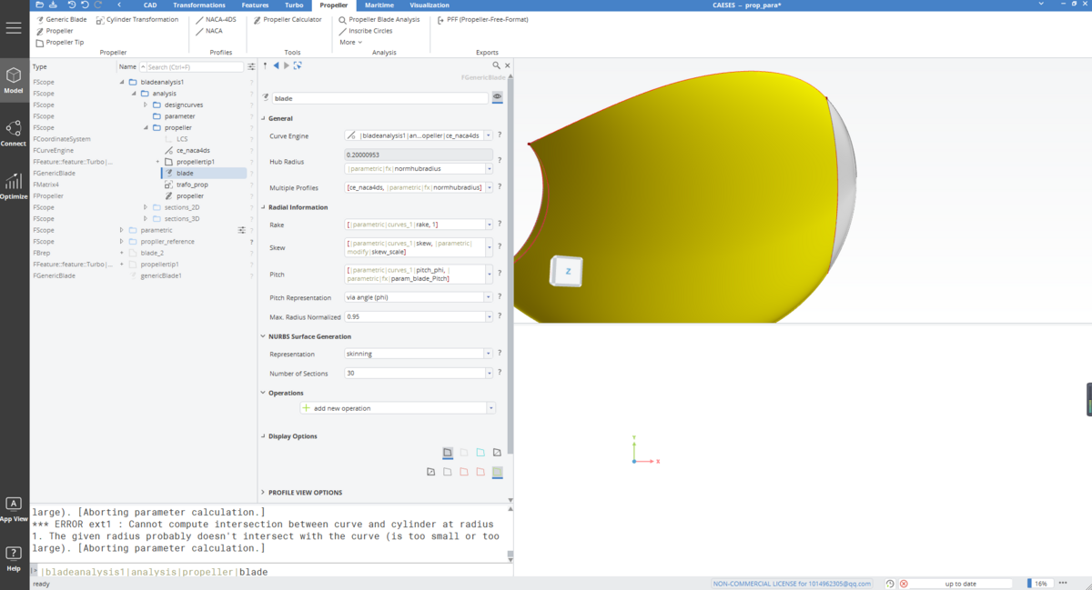

sisi 1 Report post Posted January 18, 2024 HI everyone, I'm having a hard time. I created the blades and tips. As shown in Fig. However, when I create the propeller with Model-propeller-propller, I only get incomplete blades. The tips were not created together. This is shown in the image below. Also, due to the language, I may have a problem with the description not being clear, so please forgive me. Looking forward to your answer. prop_para.cdbc 1 Share this post Link to post Share on other sites

Mr. Heinrich von Zadow 12 Report post Posted January 22, 2024 Hi Sisi, just a quick comment on that: the propeller object (type FPropeller in CAESES) does not support an actual tip. It is a type ment specifically to work with the PFF format (and be exported as such). If you want a closed, solid geometry including a tip checking out the sample mentioned by Andreas is the right way. Cheers, Heinrich Share this post Link to post Share on other sites
