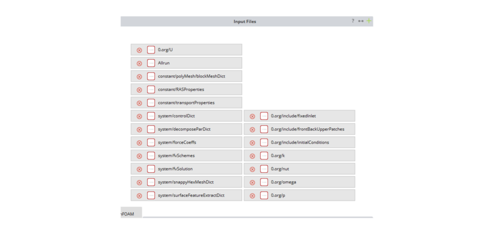

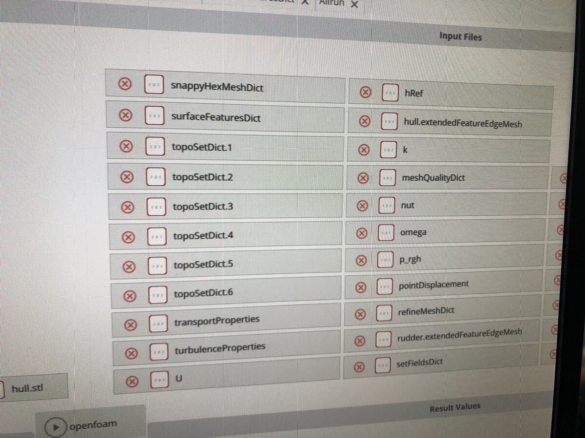

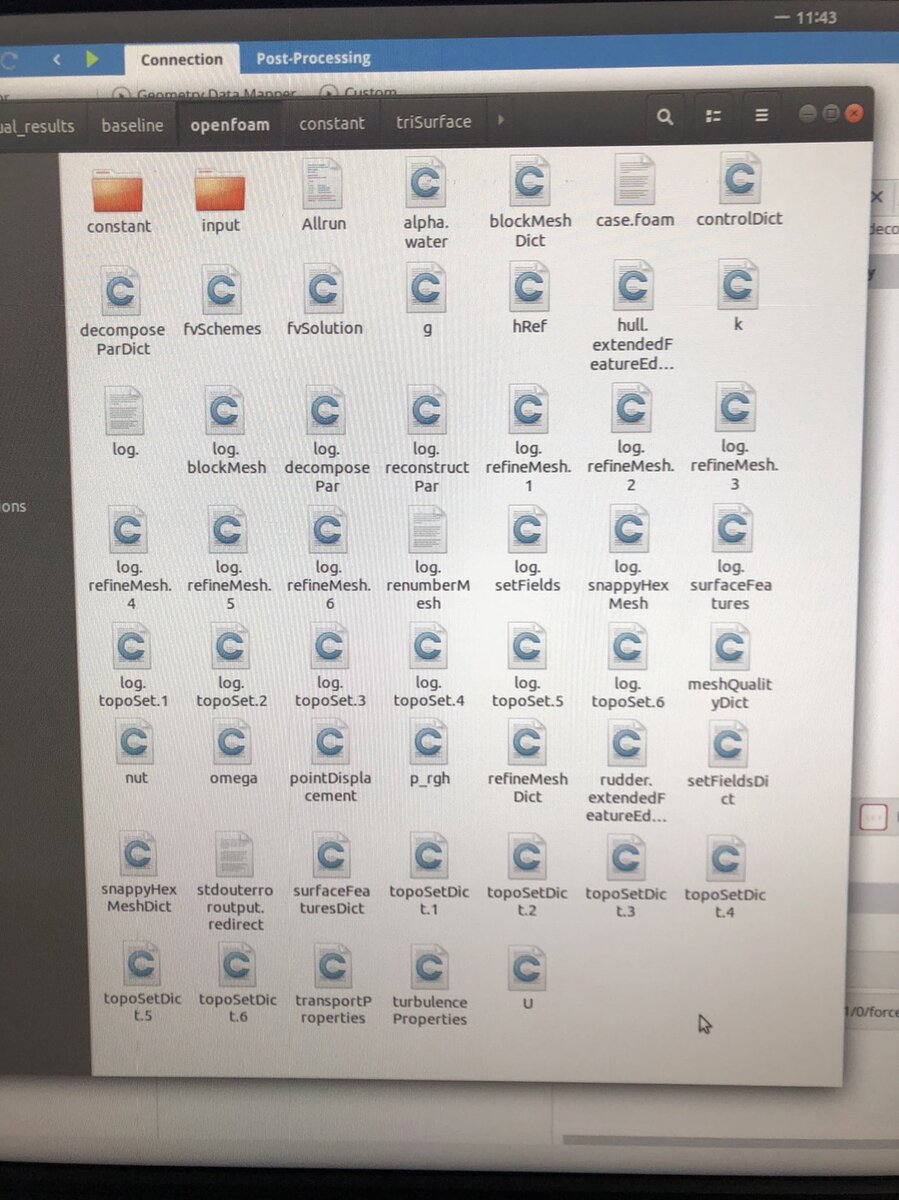

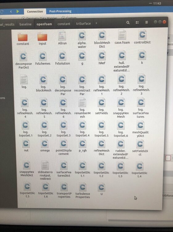

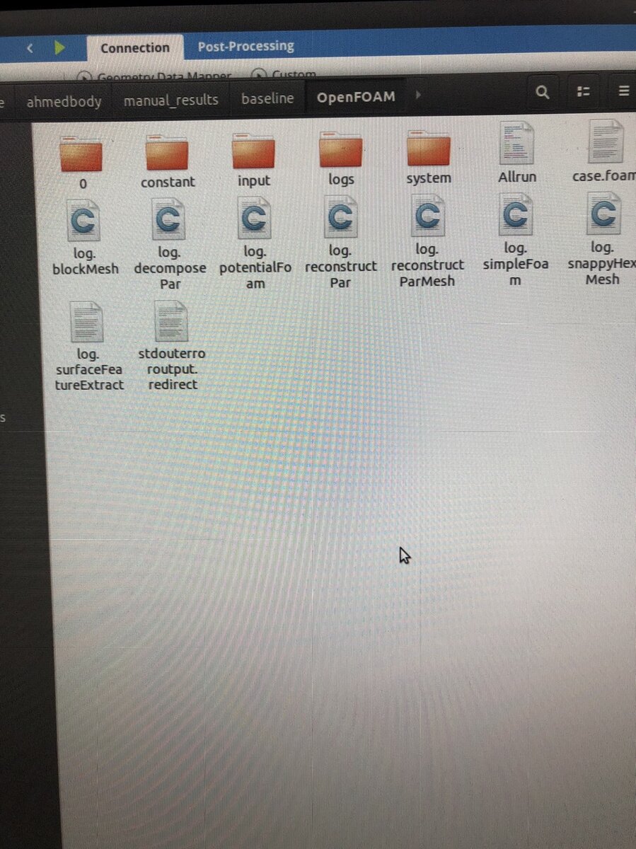

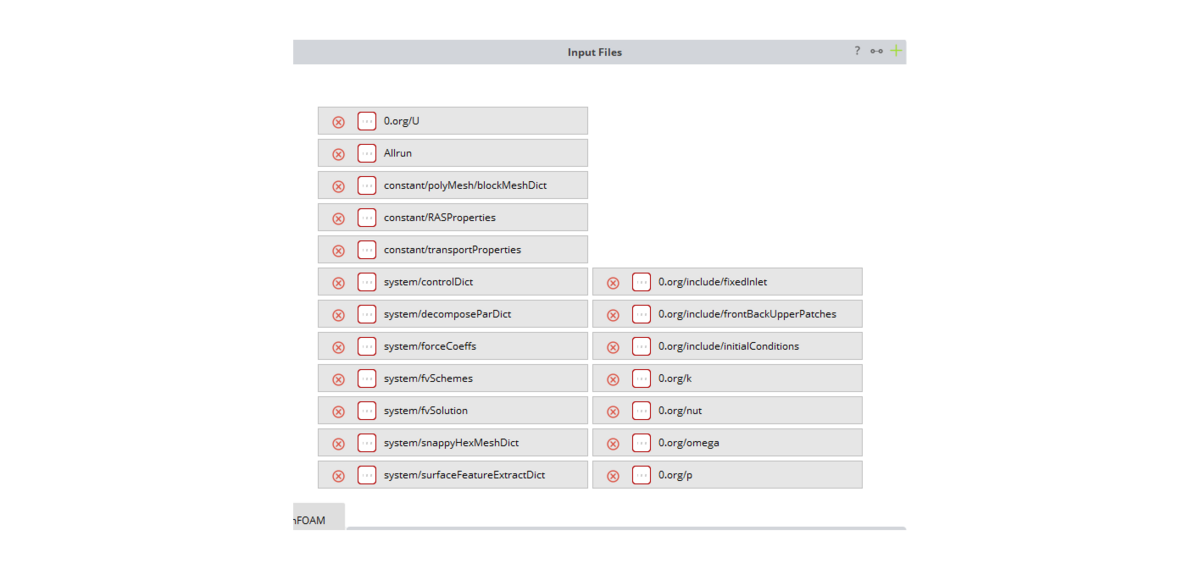

Yukai 0 Report post Posted November 6, 2023 Hello! If I check convert to Template when importing the input file, I find that my path will become wrong. How can I change the path so that the file copied by caeses can run? I have added these instructions to Allrun wmUNSET source /opt/openfoam6/etc/bashrc touch case.foam I am using the openfoam version of linux ubuntu I will compare the file I imported with the sample file and it should make my question clearer! Pictures Q1 and Q2 are comparison pictures of file paths when importing files. The example Q1 picture has system/snappyHexMeshDict, while the Q2 picture is what it looks like after I import it. Only snappyHexMeshDict does not generate a path. Pictures Q3 and Q4 are files copied by CAESES. In the example Q3, folders such as system and 0 are copied, while picture Q4 is what I tried and did not copy the folders system and 0. When I tried, I always checked the option to convert to Template. How can I solve this problem? Thanks for your help!!! Best Regards stdouterroroutput.redirect Share this post Link to post Share on other sites
Yukai 0 Report post Posted November 6, 2023 I also want to ask when we set the STL file of snappyhexmeshdict to a CAESES output file, the snappyhexmeshdict file will run out of the system and cause a path reading error during execution. How can I parameterize the content while ensuring that the file path does not Run somewhere else? Share this post Link to post Share on other sites

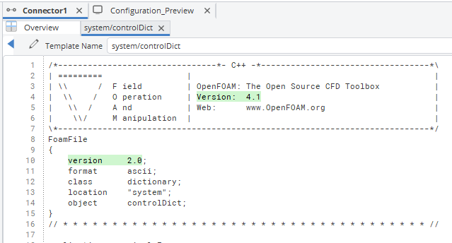

Mr. Heinrich von Zadow 12 Report post Posted November 6, 2023 Hi Yukai, you can set the sub folder by adding it to the file name of your template like this: If you have an allrun script which you execute for each design this would normally be executed in the same location as your STL file is exported to. Hence, typically referring to it by its name instead of full path works. Alternatively, you could add an entry an specify a path with getResultsDir() to have it adjust dynamically... Cheers, Heinrich 1 Share this post Link to post Share on other sites
