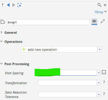

Mr. Claus Abt 14 Report post Posted September 27, 2023 Please insert a reasonable knotspacing value in the BRep and datareduction afterthe transformation. The transformation might otherwise rip the geometry apart, since it moves the control points of the vessels representation. In the flat of bottom area there might be only a few and that needs to be refined. Cheers Claus 1 Share this post Link to post Share on other sites

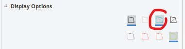

Mr. Heinrich von Zadow 12 Report post Posted October 13, 2023 Hi Carlos, without being able to look at the geometry its hard to tell. One option you might want to try is the knot spacing of the BRep you are transforming: Try and increase the density of the control polygon of your hull. A value of around 1 or 0.5 might be enough (assuming the hull is around 100-250 m or something in that...). What this will do is, insert additional control points to ensure a maximum distance of 1 or 0.5 between adjacent CPs. You can verify your choice by looking at them in the display options of your BRep: You will need enough points on both adjacent patches so that they have a chance to be within tolerances even after you have applied the transformation. In short: you need enough points to get things to work, but not too many so it doesn't get too "expensive". Hope this helps. Cheers, Heinrich Share this post Link to post Share on other sites
