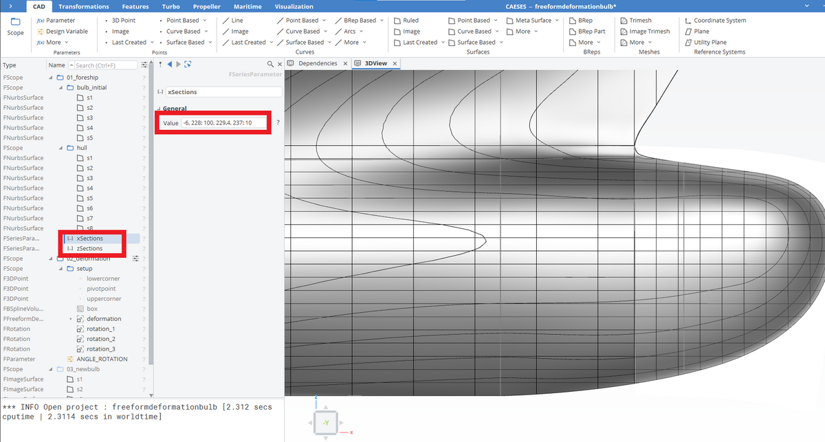

Yukai 0 Report post Posted July 14, 2023 Hello! I try to understand the parameters in the example,but I'm green hand in CAESES,there are some things I still don't understand. I don't know how the parameters in the example (red in the picture) are generated, and what the parameters mean. In addition, if the example hull model is replaced with the DTC_Hull model in Openfoam, CFD resistance simulation calculation is performed, because my project needs to optimize the hull and perform resistance simulation for comparison. How do I get started, and is there a basic tutorial on openfoam connections? Thanks for your help!! Best regards YuKai Share this post Link to post Share on other sites
Mr. Claus Abt 14 Report post Posted July 18, 2023 If you search the Help for Series, you will understand how they work. If you search for openfoam in the documentation (Help), you will get to the Ahmedbody openfoam integration. Cheers Claus Share this post Link to post Share on other sites
