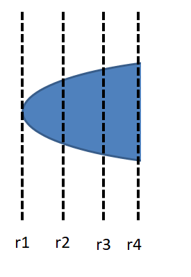

Osman 0 Report post Posted August 21, 2022 Hi Everyone, I am working on a nose cone as you can see in the image and I am using the free form deformation method. I control the nose cone with 4 different sections and I have assigned the scale ratio to be used for each section as a different design variable. So there are a total of 4 design variables(r1,r2,r3,r4). Consecutive design variable values should not be less than each other. For example, if r1 is 0.2, the lower bound of r2 should be 0.2. But I can't control it. Any ideas on how to do it? Thank you, Best Regards Osman Share this post Link to post Share on other sites
Mr. Heinrich von Zadow 12 Report post Posted September 5, 2022 Hi Osman, you can use a parameters to define the bounds and design variables to scale in-between. See attached example. Cheers, Heinrich parameterScaling.cdb Share this post Link to post Share on other sites
Osman 0 Report post Posted September 19, 2022 Hi Mr. Zadow Thank you for your help. It solves my problem. Best Regards, Osman Share this post Link to post Share on other sites
