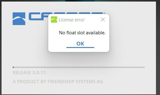

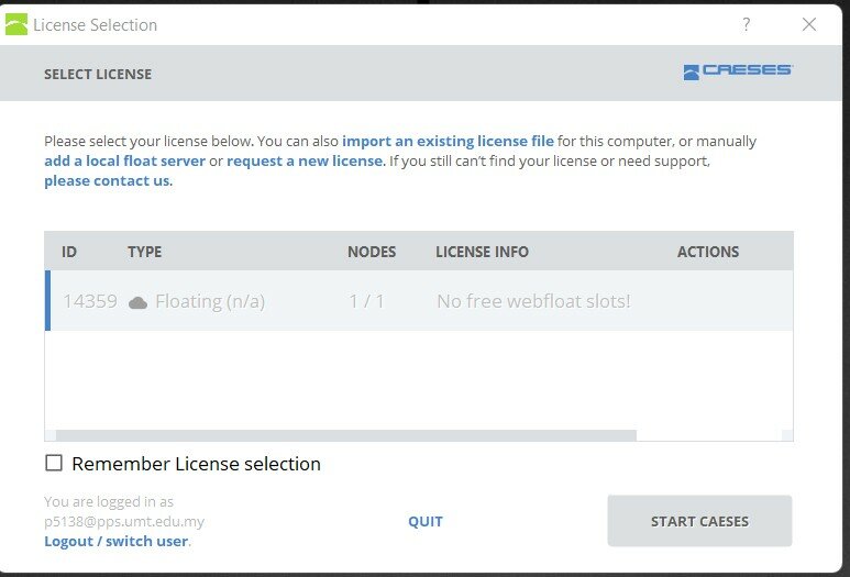

Rizuan Razali 0 Report post Posted May 29, 2022 Greeting, Something happened when i traying to login into CAESES. it say no float slot available. Can someone help me. Thank you. Share this post Link to post Share on other sites

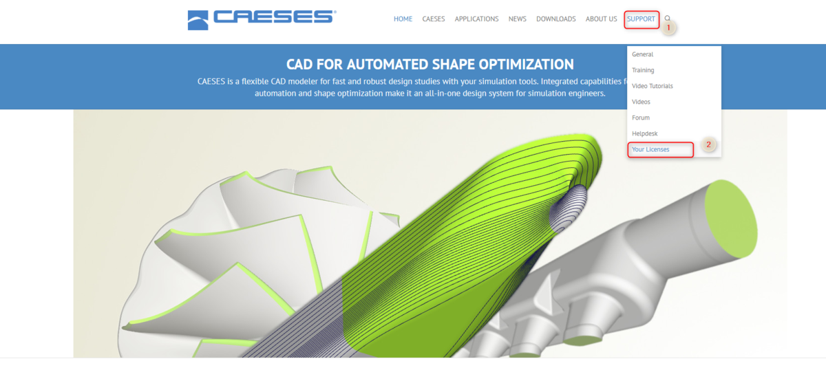

Ceyhan Erdem 15 Report post Posted May 30, 2022 Hi Rizuan, On our webpage please go to Support > "Your Licenses" Once logged in, please check the status of your license. By clicking on the manage button on the right side, you may have the option to release a hanged webfloat slot. Please let me know if this resolves your problems. Cheers Ceyhan 1 Share this post Link to post Share on other sites
