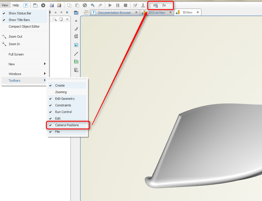

Jörg 29 Report post Posted August 26, 2013 Just a little but often very useful thing: You can save camera positions with a user-defined name and restore them with a single mouse click. The corresponding toolbar is here: view > toolbars > camera positions. See also the attachment. CheersJoerg Share this post Link to post Share on other sites
Karsten Wenzke 12 Report post Posted August 28, 2013 If you want to keep the camera position toolbar in your workspace you have to save your workspace. Click on the squared button next to File -> type in a name and click on the save button. Regards Karsten Share this post Link to post Share on other sites
