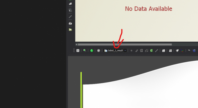

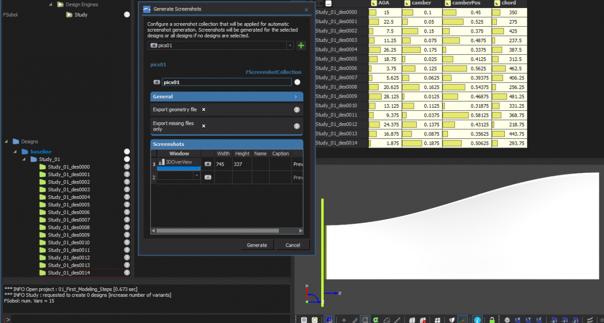

Mr. Matheus Wolff Machado 0 Report post Posted August 12, 2020 3 hours ago, Mr. Heinrich von Zadow said: Dear Matheus, - Cheers, Heinrich Thanks a lot! That's great to know CAESES never stops improving :) Regarding questions about tutorials, should i just post them here in Miscellaneous or do you have any better-suited alternatives? I'm struggling with the screenshot collection, it never shows up at the design viewer even though the preview looks fine. Share this post Link to post Share on other sites

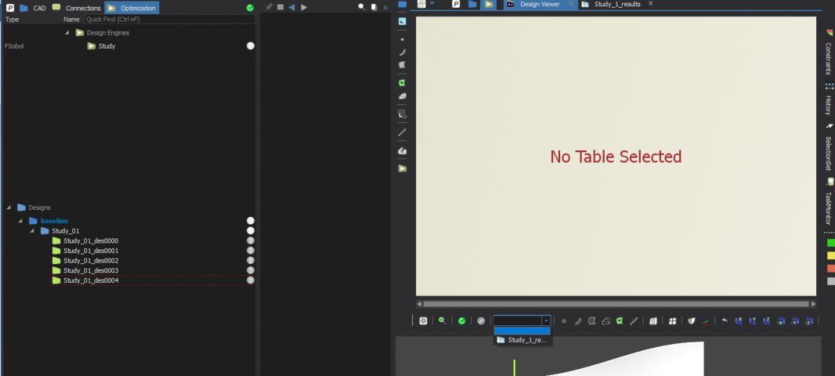

Mr. Heinrich von Zadow 12 Report post Posted August 12, 2020 Dear Matheus, I guess it's fine to post them in the misc area. Regarding the Design Viewer: have you checked that you are looking at the right results table (see Screenshot)? Cheers, Heinrich Share this post Link to post Share on other sites

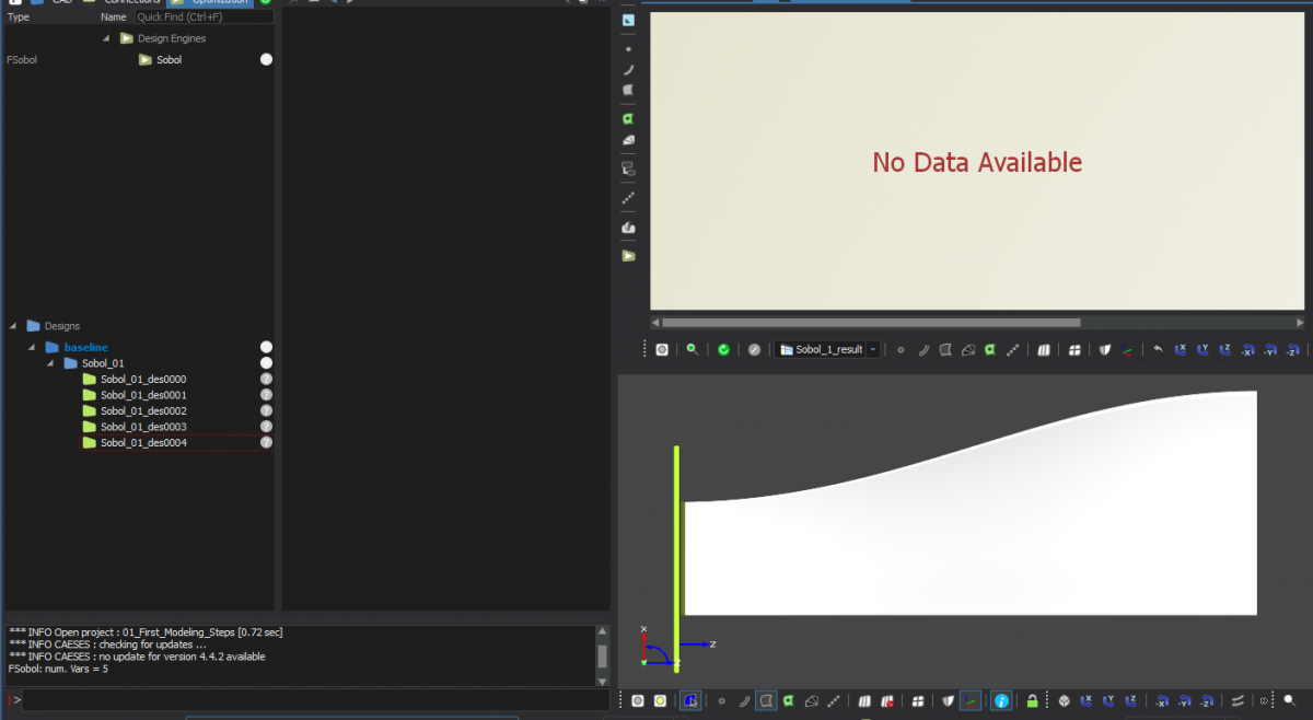

Mr. Matheus Wolff Machado 0 Report post Posted August 12, 2020 1 hour ago, Mr. Heinrich von Zadow said: Dear Matheus, I guess it's fine to post them in the misc area. Regarding the Design Viewer: have you checked that you are looking at the right results table (see Screenshot)? Cheers, Heinrich There's only this one option or a blank page, behaviour does not change whether i make screenshots during Sobol or afterwards.Fresh project, only clicks were Open Sample > Optimization > select parameters > new screenshot method > Selecting 3DView > Preview works > 5 iterations > Run. Share this post Link to post Share on other sites
