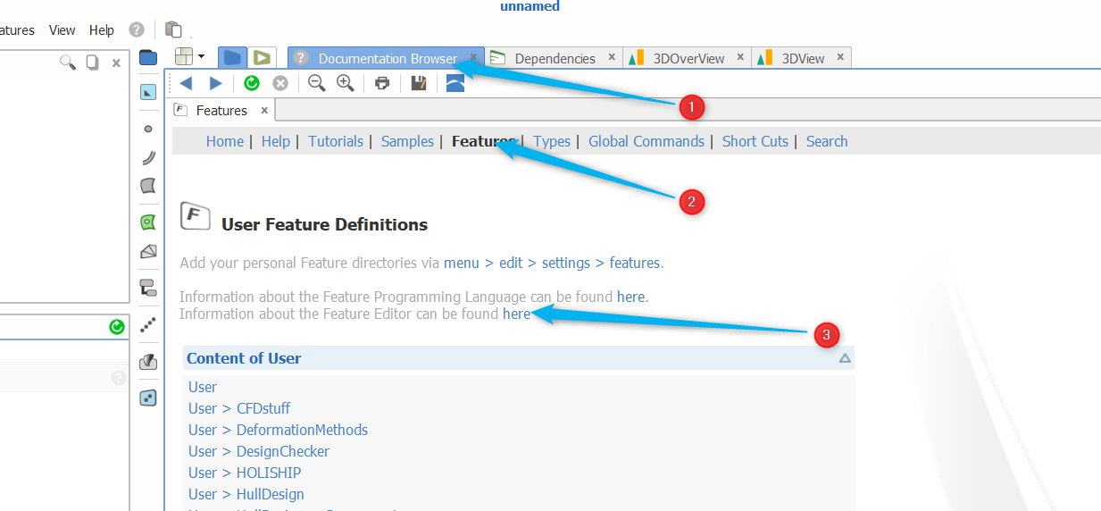

Mr. Claus Abt 7 Report post Posted July 17, 2019 Do you know how to debug a feature definition? That might help you to find the bottleneck. It might come from changes of functions provided by the COM-server of Maxsurf/Resistance etc. There is guidance in the lower part of the feature editor documentation, see screenshot.CheersClaus Share this post Link to post Share on other sites
