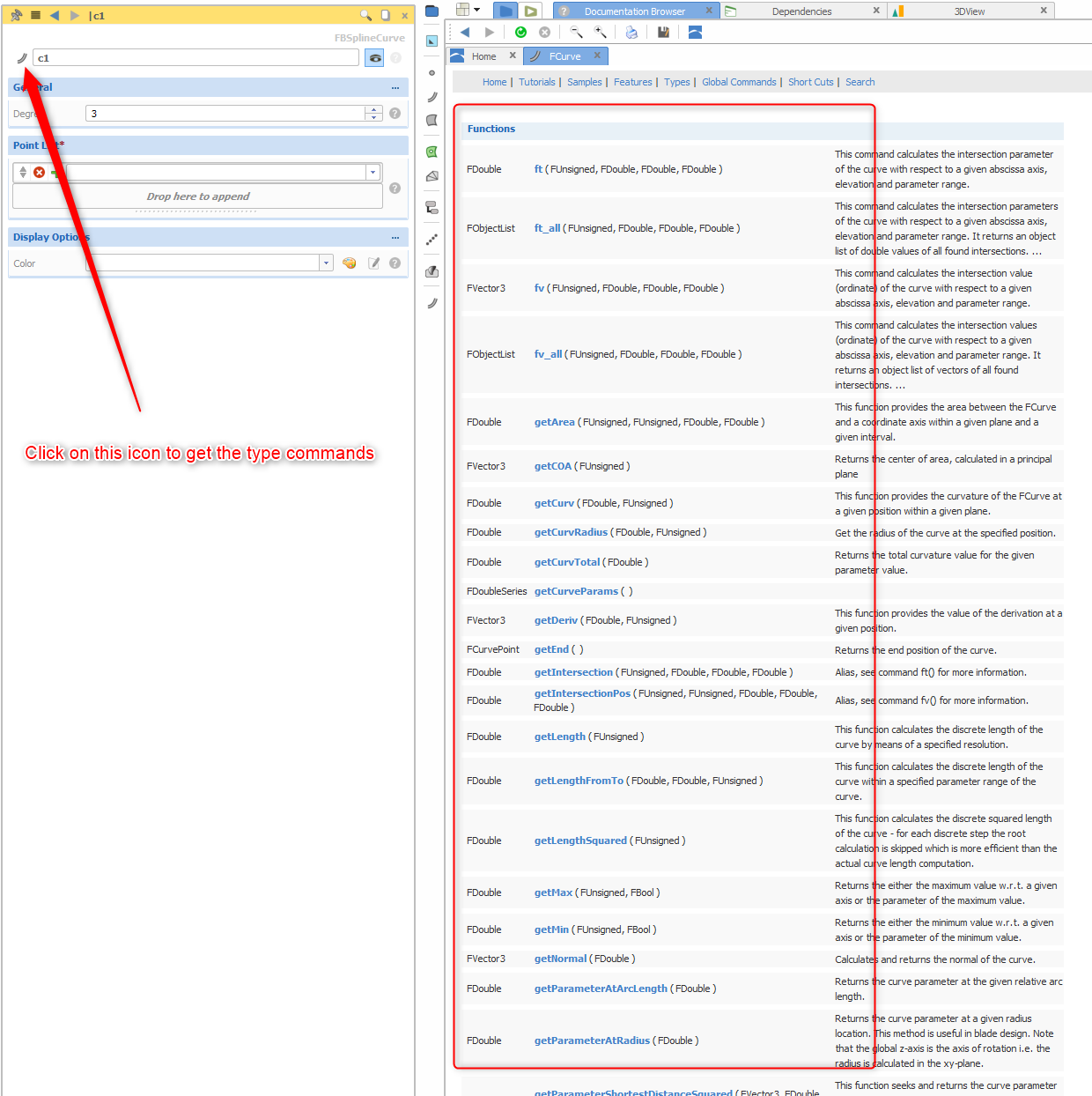

Sure (if I understand correctly). Read in the curve points, create a curve (e.g. an interpolation curve) and use the curve commands
getTan()
getDeriv()
and so on. All type commands can be accessed by clicking on the type icon: post-8-0-70142100-1533624818_thumb.png
getTan()
getDeriv()
and so on. All type commands can be accessed by clicking on the type icon: attachicon.gifcurve_commands.png

I guess you need to create a design variable and set it as input to your import/export feature (not sure about your exact setup). Then you can set this variable as value-provider for your x-column. The design variable can be changed by optimization strategies.
