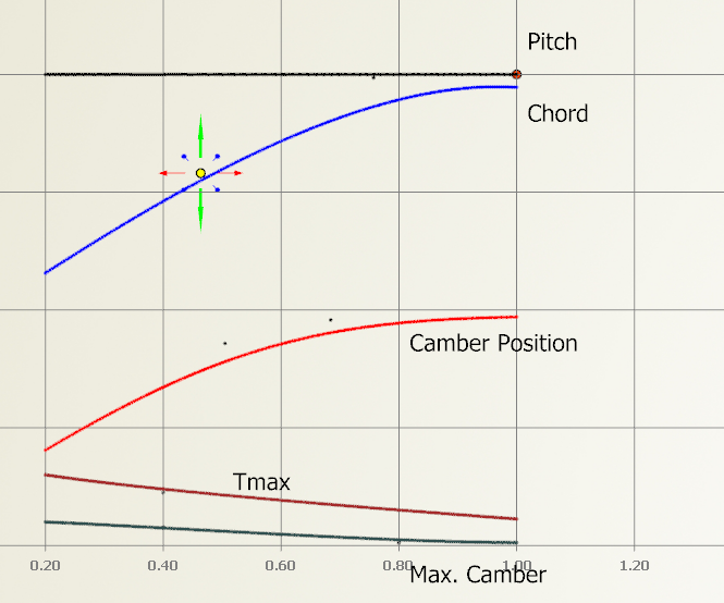

Is there a way to change the background in 3DWindow? Currently, the background is brownish and I would like to have the white background. Also. how can I increase the size of control points used for generating B-Spline curves?

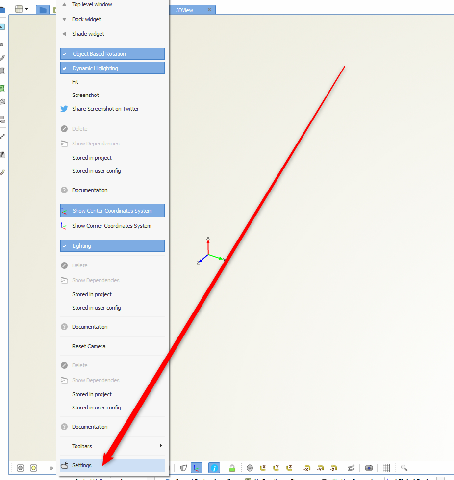

Yes, via the context menu of the 3D view post-8-0-49057000-1533186787_thumb.png.

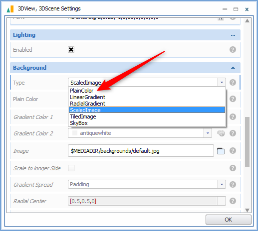

You need to choose "plain color" and then the color. post-8-0-33373900-1533186827_thumb.png

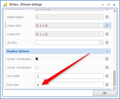

The point size can be changed at the bottom of this dialog. post-8-0-90641200-1533186855_thumb.png
