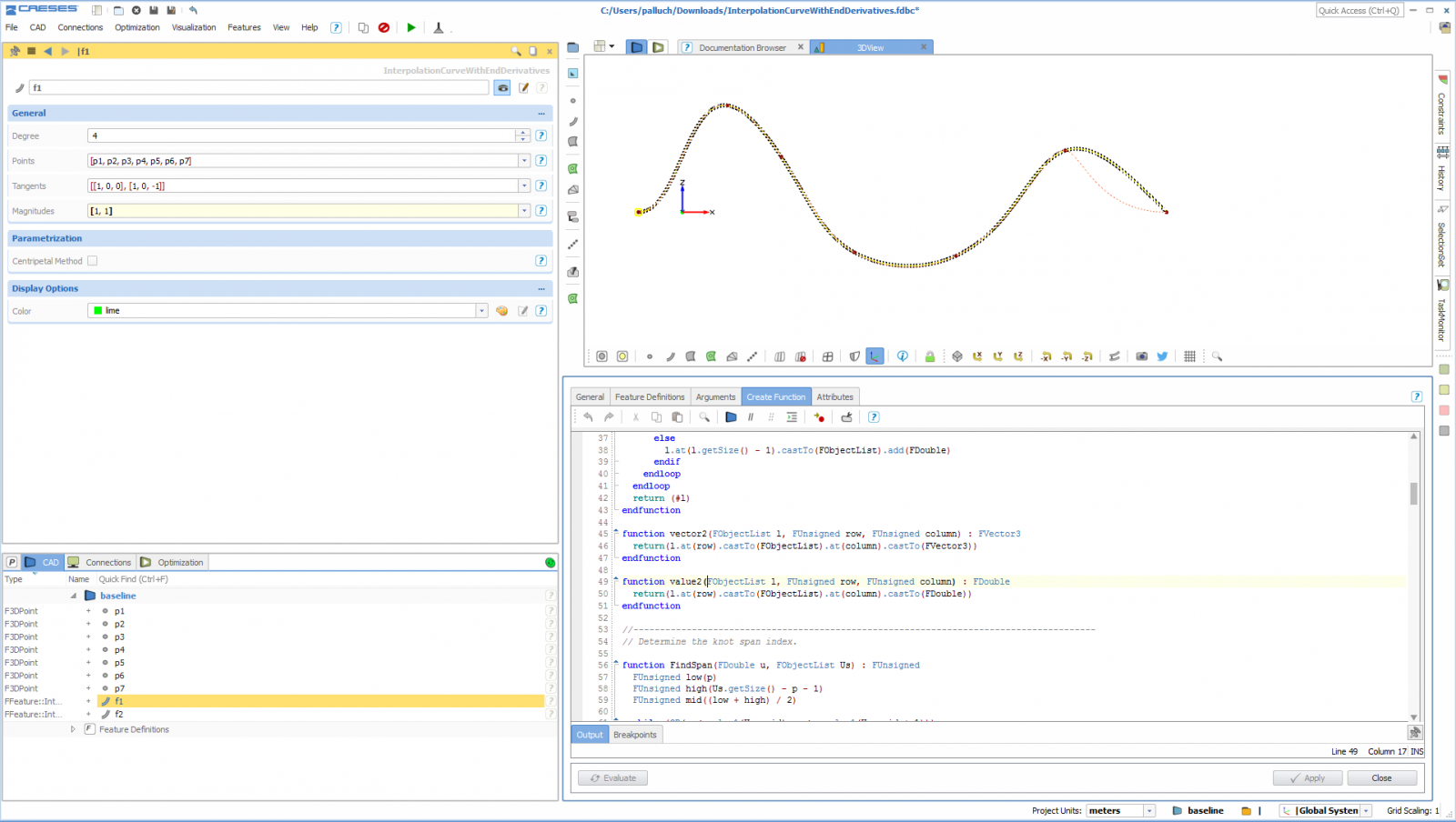

This is absolutely a working example. Realization of n-dimensional arrays. Well, for one thing, an expanded version of FInterpolationCurve. Good luck.

Hi Lalym,
I think this is really great work! Thanks for this cool stuff! I've just tried it, and it works well.
