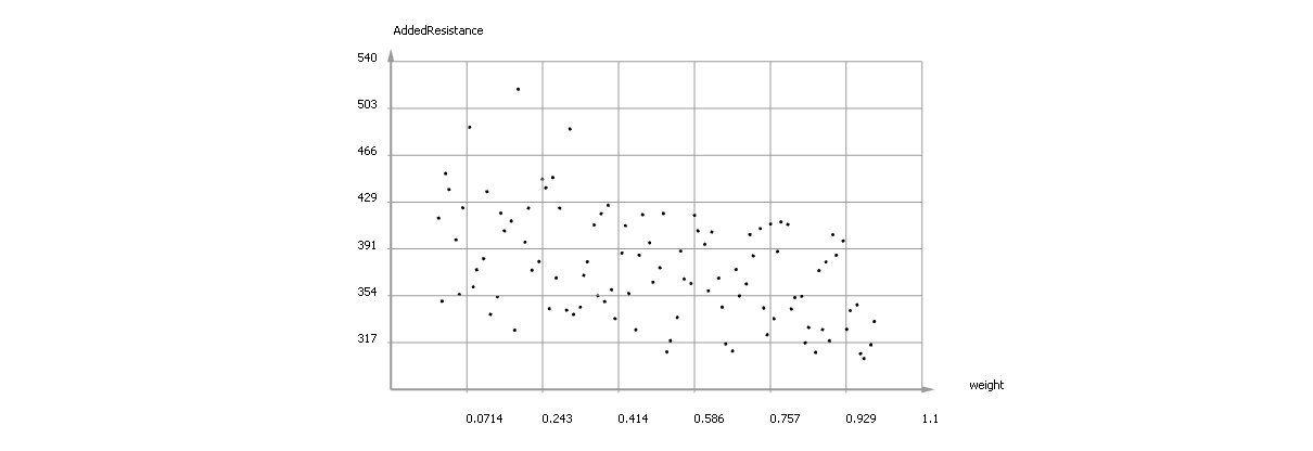

When I wanted to present results of an optimization process, it was necessary to adjust axis discretization. For instance, the discretization in x-axis was 0.0714, 0.243, while I wanted 0.1, 0.2, etc as can be seen in attached picture. The same happened with y-axis. As I understood, that is not possible in CAESES, so I had to use other utility.
This is a change I would really like to see in CAESES.

You can set the bounds of the variables in the dialog. Modify them such that the range is divisible by 7, then you get nice numbers.
Claus
