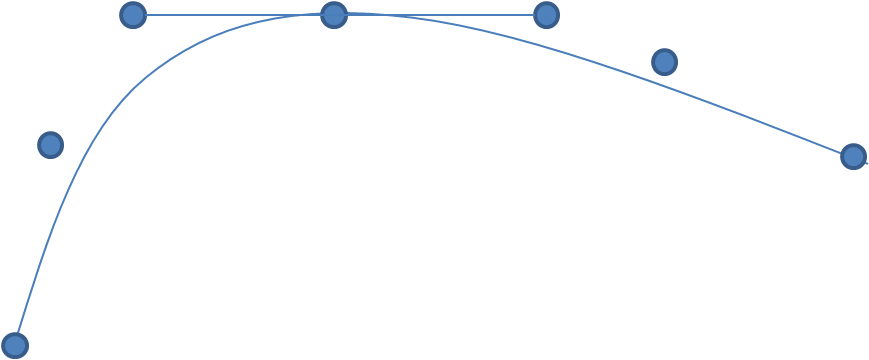

Jörg 29 Report post Posted March 20, 2013 Hi Makris, See the attachment: Are you able to define a NURBS curve like this? The distance between the connected points needs to be the same, then you will get a curvature continuous transition. Interpolation Curve: You can isolate parts by using the ft() command of curves. By providing the abscissa/ordinate information of the interpolated point(s), it returns the curve parameter for the intersection. Then, use the two curve parameters as input for an image curve (restrict the image curve's domain). CheersJoerg Share this post Link to post Share on other sites
Ms. Dimitrios Makris 0 Report post Posted March 21, 2013 Dear Joerg, The only curves that I have modeled by NURBS curves are the sections, so I have no control points that affect the continuity between two different surfaces. I am thinking of trying some hybrid methods!! The curve part isolation trick was really helpful. Thank you very much. Best regards,Dimitrios Share this post Link to post Share on other sites
