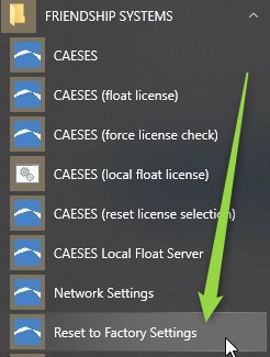

Posted 08 May 2019 - 01:00 PM
You can also try out to restart CAESES using the "reset to factory settings" menu entry: CAESES_reset_to_factory_settings.jpg
