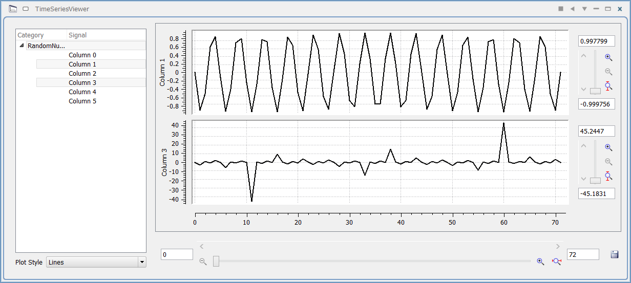

Karsten Wenzke 12 Report post Posted September 14, 2014 (edited) Hey, You want to plot your numerical result data with CAESES?You want to be able to see if your CFD results have converged or found a good oszillation?At the moment you use a plotting software for this purpose?! The TimeSeriesViewer should fit your needs. Now you have the chance to do this with CAESES with a few clicks and a short time. :-) I've created a pdf and a sample project. I am happy to share this with you and hope you like our new TimeSeriesViewer. If you have any question or you need help with the set up please share it. Cheers, Karsten You can find a tutorial in CAESES.The tutorials can be found in the documentation browser > tutorial > learn moreTimeSeriesViewer.zip04_Time_Series_Viewer.pdf Edited March 11, 2015 by Karsten Wenzke attached new tutorial pdf Share this post Link to post Share on other sites
Mr. Humberto Nakanishi 0 Report post Posted November 4, 2014 Hello all, This kind of visualition is a very nice new feature. I used to export the tables to another program to do this. I have just one suggestion. It would be nice to create those series based in table organized in lines also and not only in columns. Regards,Humberto Share this post Link to post Share on other sites
Karsten Wenzke 12 Report post Posted November 14, 2014 Hey Humberto, Thanks for for your input. We put it on our list for further improvements. As a workaround you could write a feature which transposes the data from row separated to column separated.Than you can use the time series viewer. If you need assistance for the feature let me know. :-) Cheers, Karsten Share this post Link to post Share on other sites
