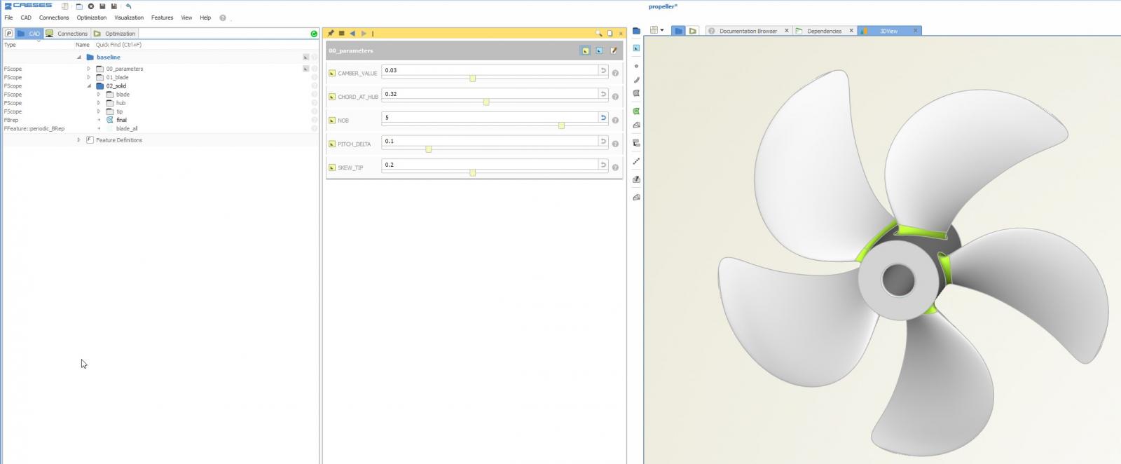

I can’t make a 5-blade propeller.
Can somebody help me?
  • 0

CAESES comes with a propeller model that allows you to set the number of blades to 5. See the docu browser > demo models. propeller_CAD_model_5_blades.jpg
Maybe you can dig into it to transfer the modeling approach to your specific design.
Jörg

Hello Jörg,
I tried it already. It is faraway from original and the description for caeses, what I found, did not allowed me to draw the correct propeller.
It isn’t intuitively.
Andrey

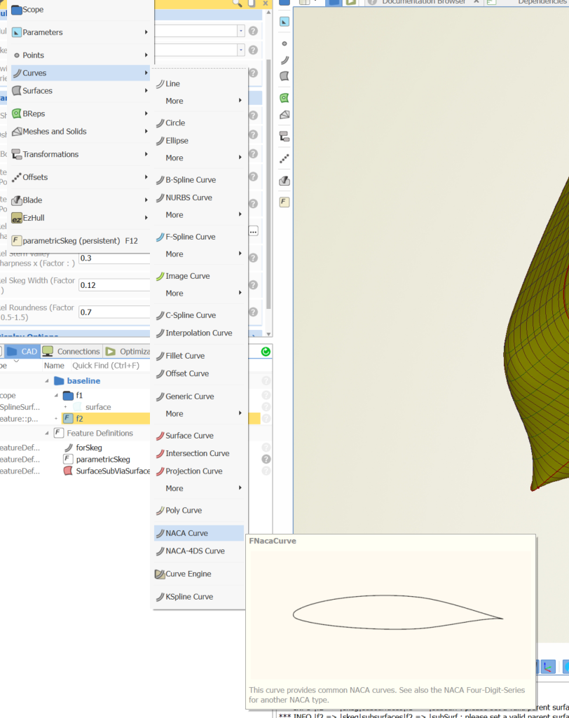

Hello,everone. Is there a good way to establish the profile "NACA66 Thickness form + a=0.8 mean line Camber"  ,the usual profile that used in propeller design ?
  • 0
#31 Mr. Claus Abt
Mr. Claus Abt
    Moderator
  • Moderators
  • 202 posts

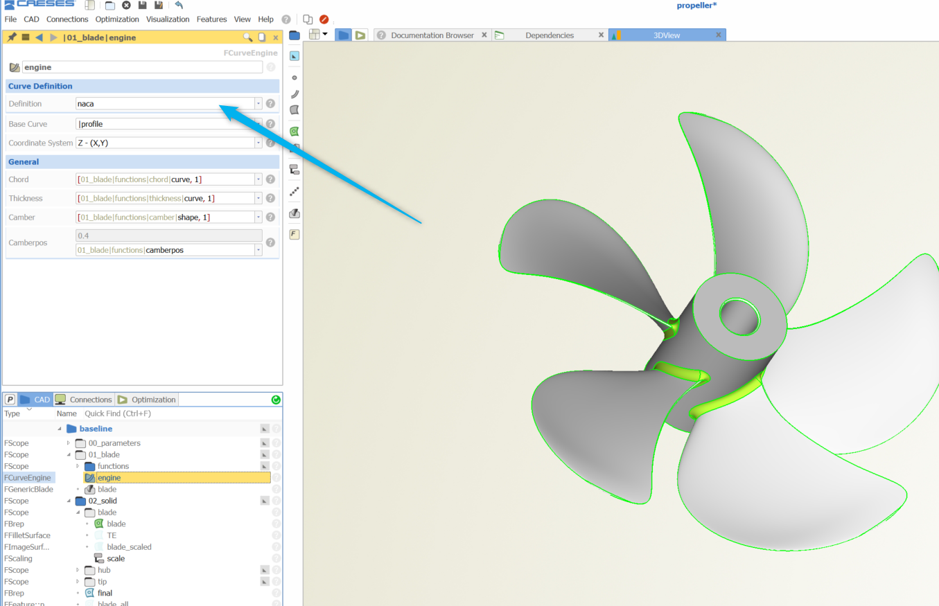

Posted 20 December 2019 - 09:07 AM
In CAESES you will find the profile definition for NACA 66 profiles.
For its use in a blade definition, you have to put it into a feature definition, similar to the NACA 4D which comes with the samples. You have to replace the feature definition in the curveEngine for your blade by your own definition which then is based on the NACA 66.
Bests
Claus
Thank you Mr. Claus Abt,
I find that  CAESES provides a number of naca 6 series airfoil ,naca66-006 ,66-008 ,66-010 and something like that.However the airfoil "naca66 a=0.8" is  a kind of combined airfoil and  have not been contained in CAESES.Thank you anyway ,spline curver maybe help.
