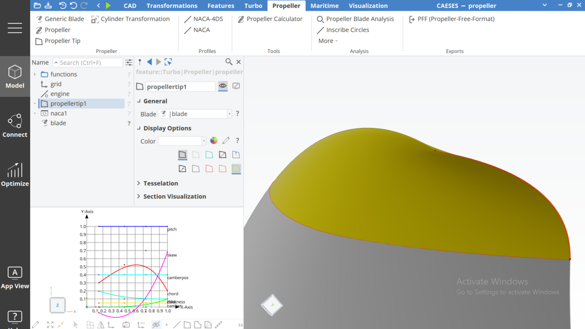

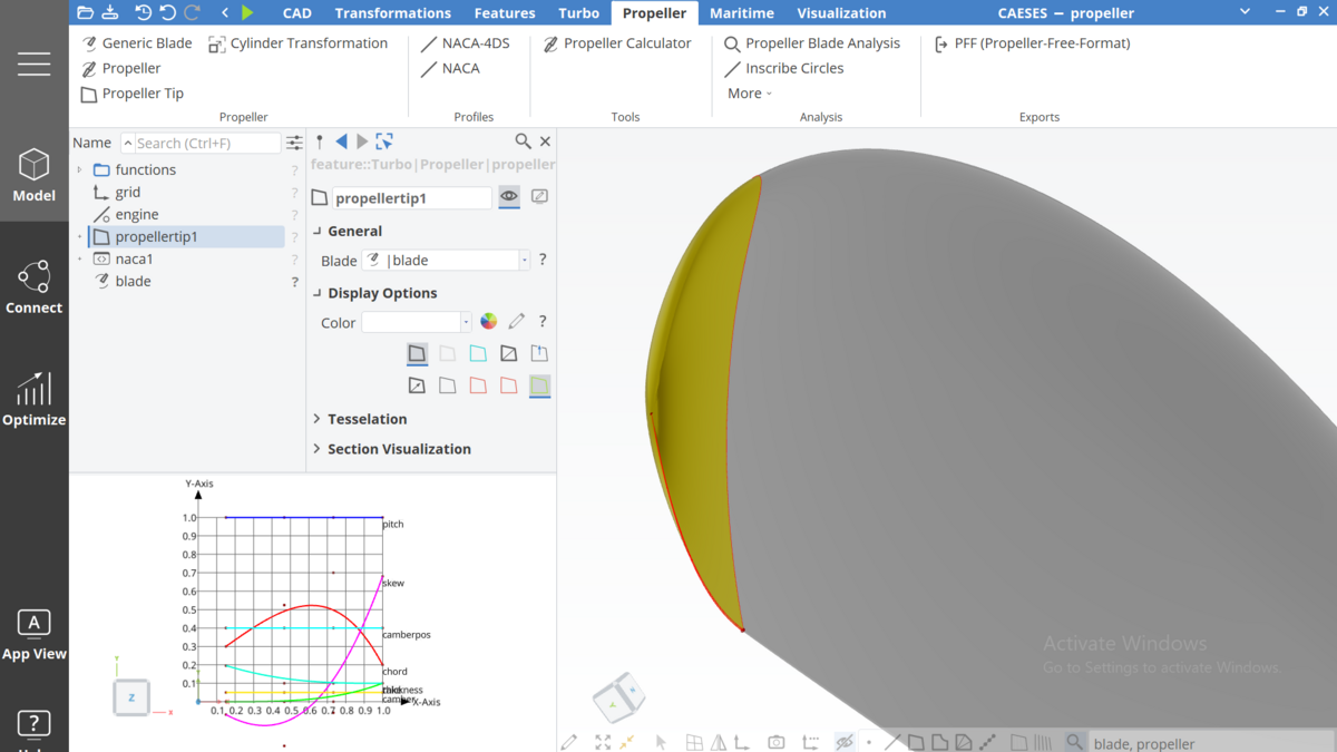

Masteriti 0 Report post Posted April 15, 2024 I reduced the maximum radius of my blade to 0.95 and then adding the propeller tip as the official guide suggests, but I ended up with this weird folded geometry for me at the tip. I played around with the maximum radius with no change, so I'm not sure what's causing it. Does anyone know how to fix this? Here are some pictures of the weird tip geometry; I also attached my project file below. propeller.cdbc Share this post Link to post Share on other sites
Andreas Arapakopoulos 2 Report post Posted April 16, 2024 Hi, Attached is a revised version of your project with the correct tip geometry. The changes I made involve setting the camber close to the tip region to zero. This adjustment addresses inconsistencies in tip geometry and does not significantly impact performance, as is common practice in propeller design. I also included the trailing edge (TE) surface, as required by the NACA geometry used for the curve engine. Given that the engine has an open TE, the blade surface needs to be closed with a TE surface for proper alignment. In summary, I followed the propeller sample workflow to ensure accuracy and adherence to design standards. Best Regards, Andreas propellerTipRev.cdbc Share this post Link to post Share on other sites
