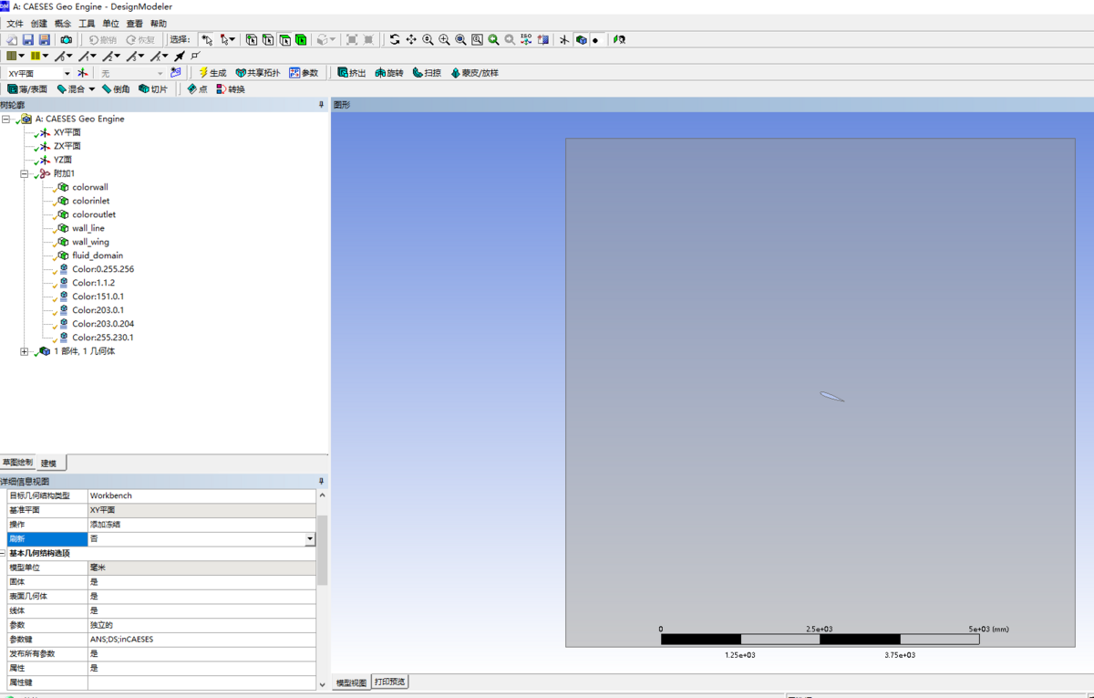

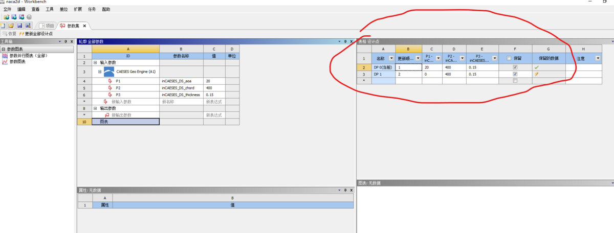

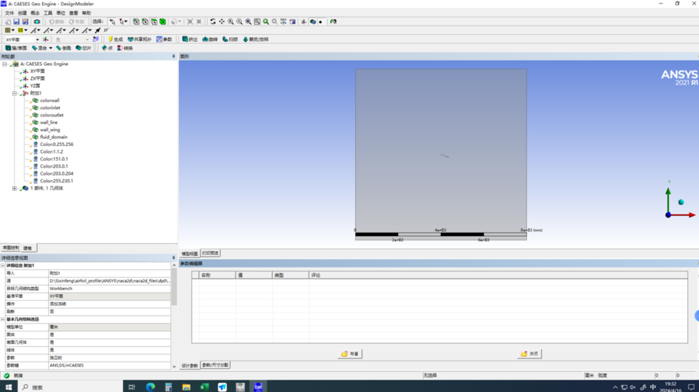

sisi 1 Report post Posted April 16, 2024 19 hours ago, Ceyhan Erdem said: Hi Sisi, Glad that it worked. Please remember that due to changes in design, your BRep Edge numbers may change as well. Creating an inconsistency and hence failure to assign a color. You can use the attached simple Feature Definition where the user is expected to add the edges that will create the 2D geometry as input. Please assign the colors to the edges before adding to the list. The fature then will create a BRep using the provided edges and then assign those colors to the corresponding BRep edges. Cheers Ceyhan 2D_boundaries_forNamedSelection.fdf 2 kB · 1 download Hi Ceyhan, I'm sorry to bother you again. I still have problems with parameter updates. At the moment, I can change the parameters from DP0 in the workbench parameter set, and the model changes in the DM as well. But when I update the design points DP1, DP2, DP3...... , there will be no changes to the model in the DM (picture1). I've changed some settings about DM, but it's still not going well. Also, for some reason, in DM, the parameter bar is blank(picture3). Earlier when I used solidworks to import a parametric model, I needed to tick the parameters in the DM. I hope you will be able to help me with this. The following images may help. Share this post Link to post Share on other sites
