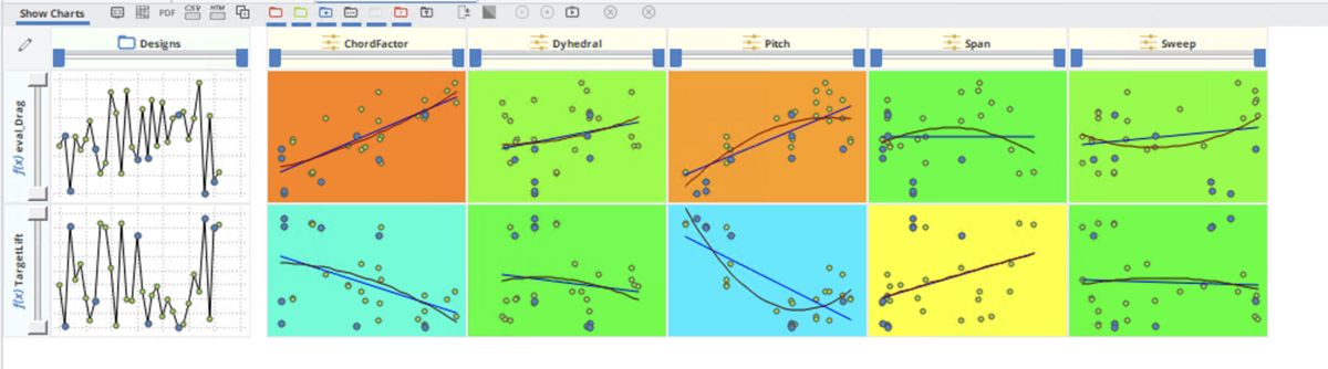

Max F 0 Report post Posted March 18, 2024 Hello, I was wondering if CAESES had a functionality to export this nice charts layout as png or similar straight away ? Share this post Link to post Share on other sites

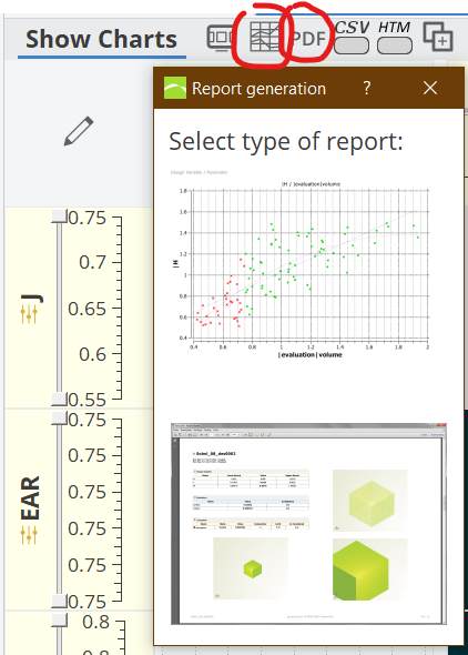

Andreas Arapakopoulos 2 Report post Posted March 20, 2024 Hi Max, You can enhance your analysis by capturing screenshots of these diagrams and adjusting the size of the graphs as needed. Alternatively, you can generate images in .PNG format using the "Generate interactive diagram" feature or by creating a PDF report. Best Regards, Andreas Share this post Link to post Share on other sites
