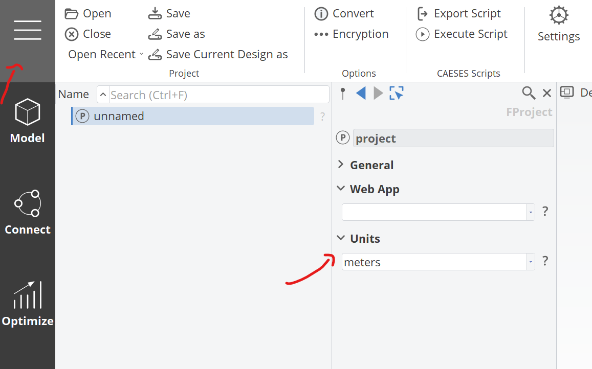

sisi 1 Report post Posted January 23, 2024 On 1/18/2024 at 6:52 PM, Andreas Arapakopoulos said: Hi again, I recommend starting by examining the sample propeller provided in CAESES, as it offers a comprehensive representation of geometric modeling for a propeller, encompassing both the hub and tip. Best Regards, Andreas Dear Andreas, Thank you. I solved the problem of propeller modeling from the example you mentioned above. After that, I started the simulation. I looked at the tutorials and cases of the workbench interface. However, when I finished building the model and importing it into ANSYS Workbench, I looked at it in SCDM and the model was always magnified 1,000 times. This makes automated simulation and optimization impossible. I'm guessing there might be something wrong with workbench's unit system, and my setting of SI units to default is invalid. I wonder if you can solve this tricky problem? Sincerely, respects. 司思Si Si Share this post Link to post Share on other sites
Andreas Arapakopoulos 2 Report post Posted January 24, 2024 Dear 司思Si Si, Please verify in Caeses that the units are correctly set to the appropriate ones. For instance, you might have specified units in millimeters, but if the project is set in meters, overlooking this could potentially explain why the model appears to be consistently magnified by a factor of 1,000. Best Regards, Andreas Share this post Link to post Share on other sites
sisi 1 Report post Posted January 25, 2024 Dear Andreas, Thank you for your answer. I've noticed you mentioned this, but this doesn't solve the problem. In CAESES, my fluid domain length is 4.2m. When I set it to meter on the above page, it's 4200m in ANSYS Workbench. When I set it to milimeter on the above page, it was 4.2mm in ANSYS Workbench. So neither of these units can get the right value, and that's what confuses me for a few days. Sincerely, respects. Si Si Share this post Link to post Share on other sites
