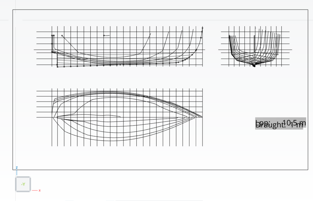

CJ Coll 0 Report post Posted January 13 I am having a similar problem, where I am creating a lines plan, but I cannot move my text for the Lpp and draught so they overlap. Is there a way to change this? Also is there a way to add a line that follows the bulwark / topdeck and remove the points in the profile view? Share this post Link to post Share on other sites
Weber 1 Report post Posted January 18 Hi CJ Coll, I edited the feature so that the labels are not on top of each other anymore and the points are removed inside the profile view. You can find the edited linesplan feature attached to this reply. To toggle the visibilty of the orientation points from the group section curves, you can use the command .setShowOrientation(true/false). If you want to further edit the feature yourself, you can access the it in your CAESES installation directory under "CAESES...\etc\features\features\Maritime". To add a line that follows the topdeck, my solution was to create an image curve from the hull's surface/brep upper edge. I hope that solves your problem. If not, don't hesitate to ask. Linesplan_edited.fde 1 Share this post Link to post Share on other sites

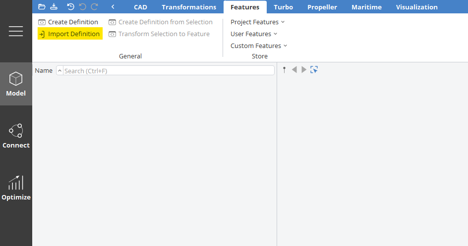

Weber 1 Report post Posted February 5 Hi CJ Coll, Apologies for the late response. I would simply import the edited feature definition via "Import Definition" which is located in the "Features" section in the Model Workspace. After the import, you can right-click on the feature and select "Create Feature" to create a feature in the object tree. To view and edit the feature, double-click on the feature inside the "Features" section. To locate commands inside a feature, you can use the searching command (Ctrl+f). You can find the commands in the lines 30,35 and 40 and just change the input from "false" to "true" in order to make the objects visible. I hope that answers your questions. Best regards, Johannes Share this post Link to post Share on other sites
