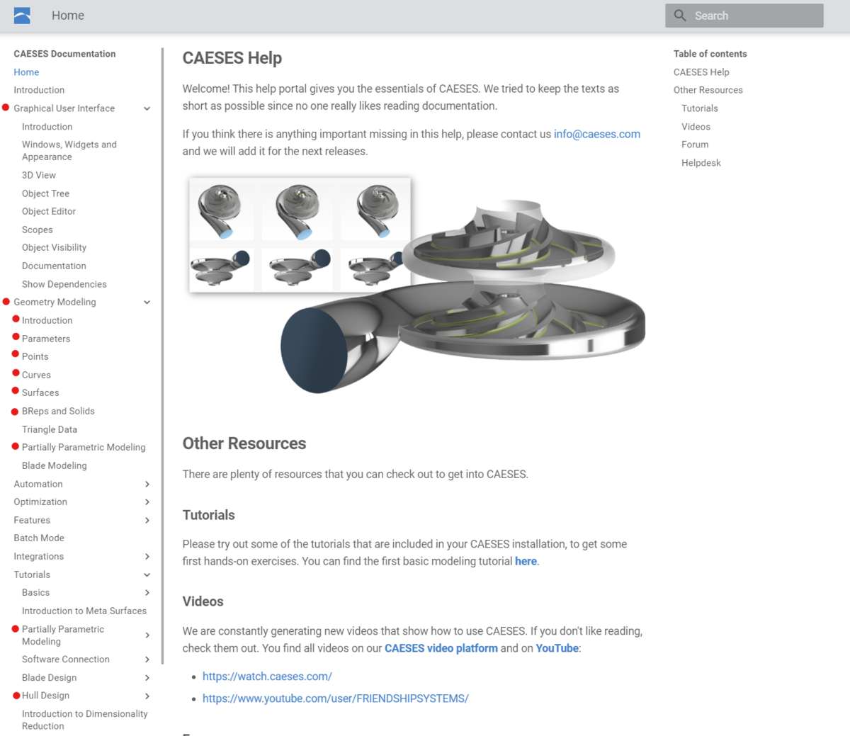

Susan 0 Report post Posted November 13, 2023 13 minutes ago, Mr. Heinrich von Zadow said: There is plenty of material. Have you had a look into the documentation? Unfortunately, I don't have any materials and can only rely on the help documents in the software,and I do not find some material about full parametric modeling. Share this post Link to post Share on other sites

Mr. Heinrich von Zadow 12 Report post Posted November 14, 2023 Hi Susan, I'd recommedn to start with these: (they are part of any CAESES installation) Share this post Link to post Share on other sites

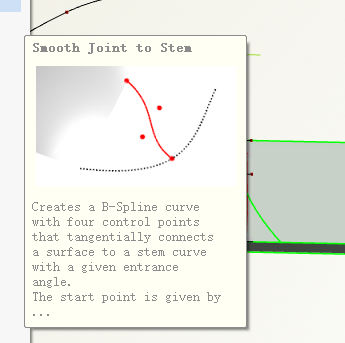

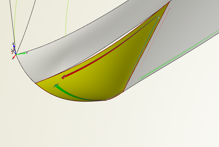

Susan 0 Report post Posted November 17, 2023 On 11/14/2023 at 3:42 PM, Mr. Heinrich von Zadow said: Hi Susan, I'd recommedn to start with these: (they are part of any CAESES installation) Hi,Mr. Heinrich von Zadow,I find a sample and learned it ,now I built some surface of the bow, but there is a surface can not match with other surfaces. I wonder if you have advice. Thankfully!!! I used the future below. And result is as follows. Share this post Link to post Share on other sites
Mr. Heinrich von Zadow 12 Report post Posted November 17, 2023 Hi Susan, If you use this method "smooth joint to stem" for the selected surface in your screen shot you will have to make sure the adjacent surface is defined such that it results in the same shape along the joint edge (possibly you will also want continuity accross the edge -- that would be another thing to keep in mind). What about you trim the upper surface and extend the lower one all the way to the max height? BTW: Which version of CAESES are you working with? Looks like a 4.x to me. I definitely recommend to update to the latest 5.2.4 -- there is years of development in between them. Cheers, Heinrich Share this post Link to post Share on other sites
