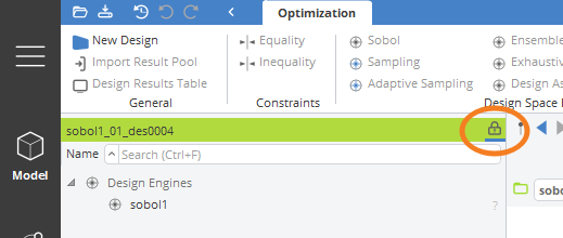

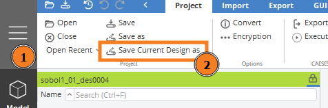

Carl Benz 5 Report post Posted October 4, 2023 Hi Carlos, please use a personal message (click on my profile -> message). Out of your last question about starting CAESES in Baseline or in designOfExperiments I assume, that you made a lot of work not with the baseline design. For CAESES each design is its own instance, and they are not connected with each other. So if you doubleclick on a design from a design engine the name of the design on top of the objecteditor gets a green background with a (by default) closed lock. For sure you can make some changes by unlocking the design, but as I said already it will not infect the baseline design. As any design engine starts from the baseline design, this might be the cause for the original issue you reported. If you want to continue working on a specific design from a design engine, you need to make it the baseline-design first: Go inside the design you want to make baseline (doubleclick -> green bar) and "Save Current Design As" a new clean project (without results from the previous design engines). I hope this helps. Best, Carl 1 Share this post Link to post Share on other sites

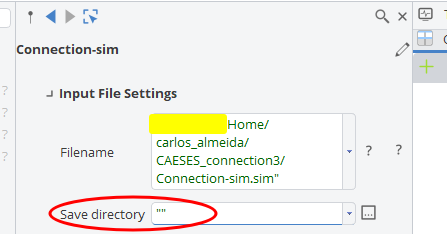

Carl Benz 5 Report post Posted October 5, 2023 Hi Carlos, you get the message about not influenced evaluations, because you called a sobol to minimize the parameter eval_rt. As a sobol is only a randomized design engine and no optimization algorithm, the message is true and informing. If you click "Yes", it will simply run the sobol. If you don't want to get this message you have to set the objective to "observer" (default). I can't reproduce your simulation, because of the .sim file, which is only referenced and not attached in your project. But the reference itself is not set correctly. If you want to call the .sim file for each design inside the results directory (as you set in the argument section of you computation) you simply need to empty the string of the "Save directory". Then CAESES copies the file from "Filename"-location to "Save directory" which is always relative to the design folder. PS: To test, if a software connection has all inputs (referenced or edited files) needed to be ready for any design engine, it is helpful to delete the "manual_results/baseline/<connection>" folder (or make a backup if you think you need it) and let CAESES do the job. If any file is missing (or wrong referenced), you will notice. Best, Carl Share this post Link to post Share on other sites
