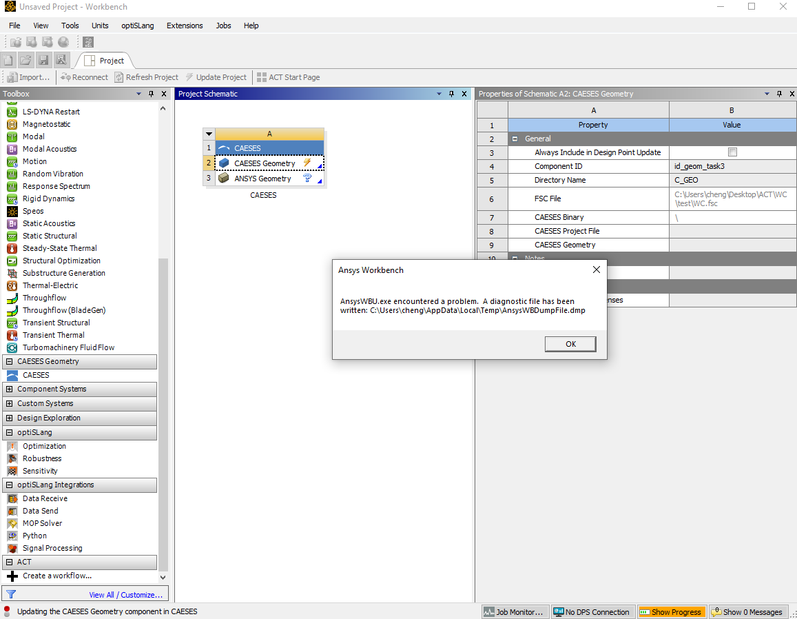

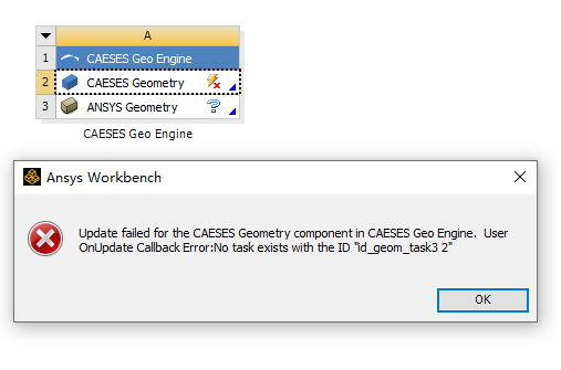

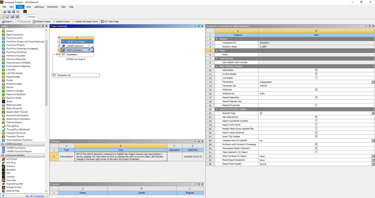

Hello everyone.

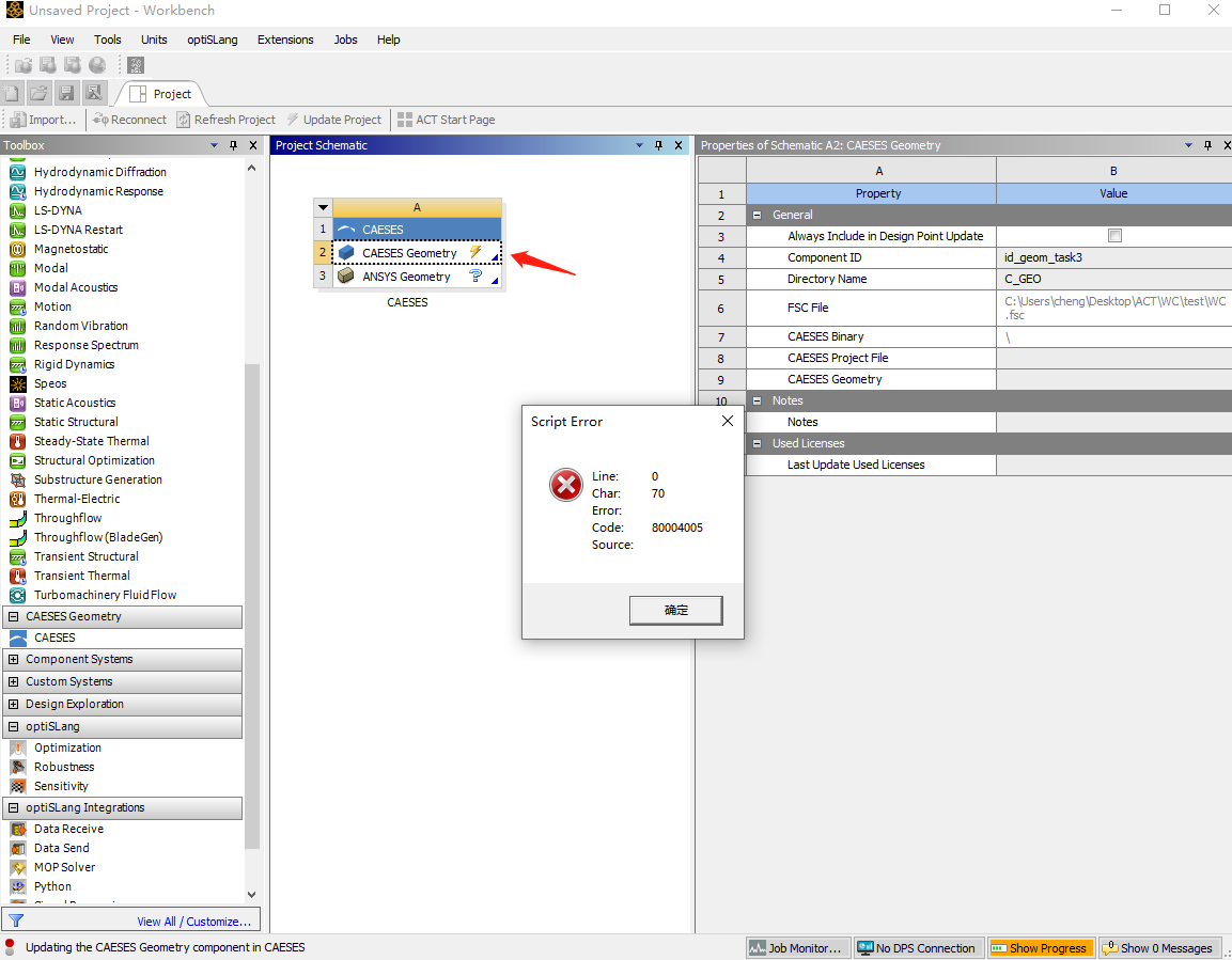

I'm trying to import a CAESES model into Workbench, but the geometry cannot be imported into ANSYS Geometry.
I have read the relevant tutorials in the software in detail.
CAESES 4.4.2,Ansys
Thank you very much for your reply!
test.rar

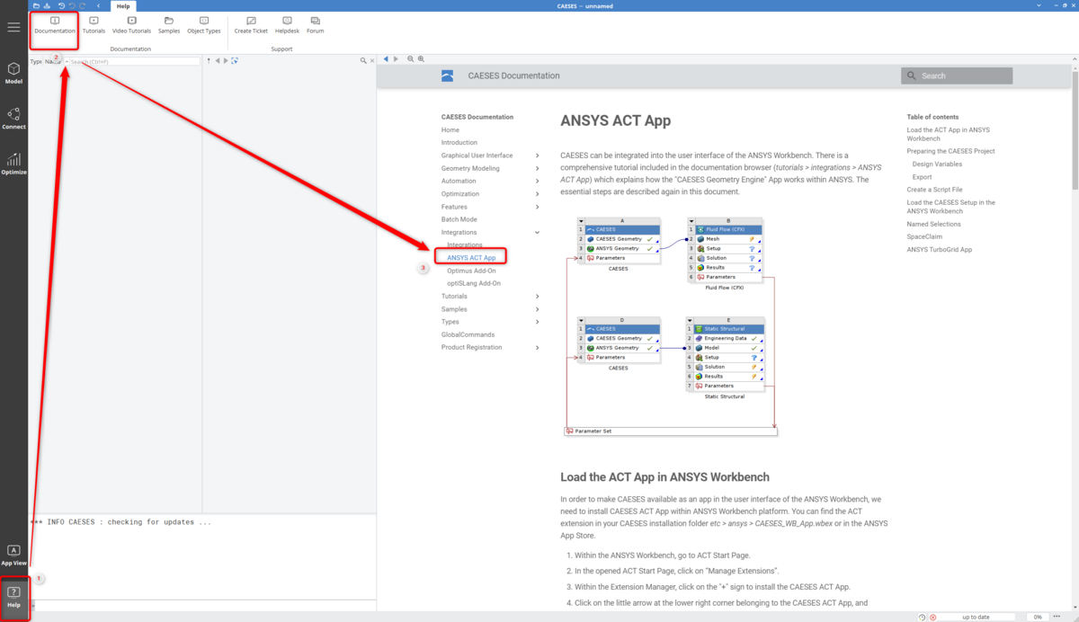

Hi Jake,
I will recommend you to use the latest Caeses version which is v5.2.2 for the time being. Within the installation files you can find the updated ACT App.
Thank you for your reply.
Luckily I solved this problem in lower version. Geometry can be imported into ANSYS geometry.

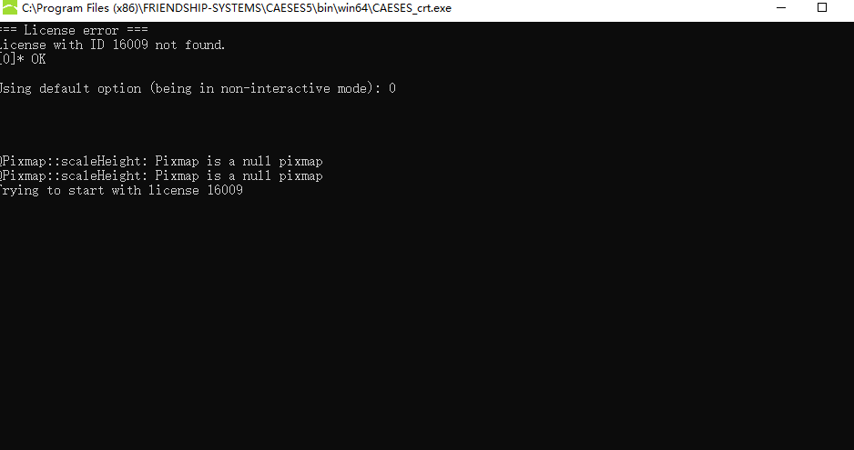

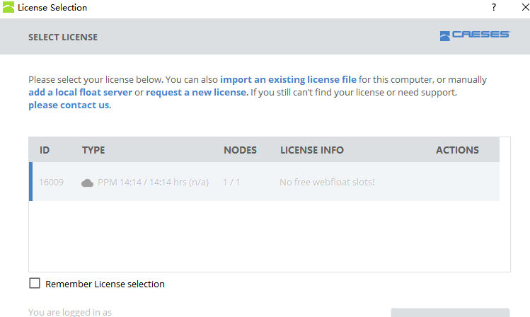

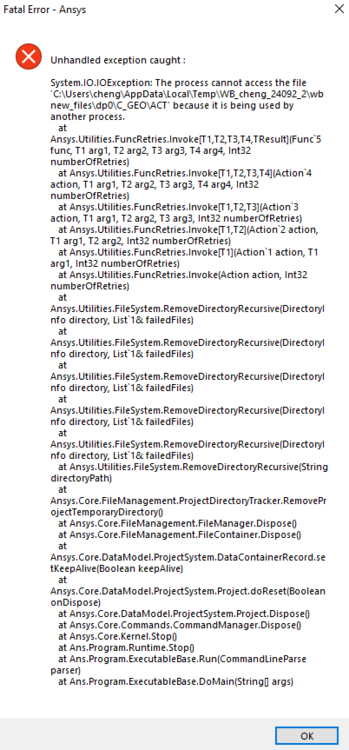

However, in version 5.2.3, it cannot be imported into CAESES Geometry. Every time I open version 5.2.3, I get license related issues.
Therefore, I speculate that the problem may be related to license or firewall. Please help me confirm whether it is a license issue, thanks!

Hi Jake,
We have checked your license and normally you should not encounter any issues.
While trying, can you please be sure that no more than two Caeses instances are open already? I don't think this is the cause and we should have received another error but let's be on the safe side. (Your free license should be supporting two Caeses instances only at the same time)
Below you can find the link for the previous Caeses version; maybe you would like to give a try and let us know
https://www.caeses.com/downloads/software/software-archive5/CAESES_5.2.2_win64.exe
We believe this is an issue caused due to an intervention, as you have mentioned, maybe a firewall. I am unable to recreate the problem.
I did not open more than two Caeses  at the same time. I think it might be due to license issues. For example, when working on the workbench, Caeses will verify the license together. The verification may have failed due to a network problem. I will download version 5.2.2. If there is any progress in the future, I will let you know, thank you for your reply!
Looks like a license issue. My permit will expire on August 23rd. However, Caeses cannot be opened right now. Please help me check if there is any problem with the license, thank you very much!
Hi Jake,
As mentioned before we have checked your license and you have the necessary rights to run Caeses in batch mode. Also since it is a free license, you are allowed to run up to two sessions of Caeses at the same time.

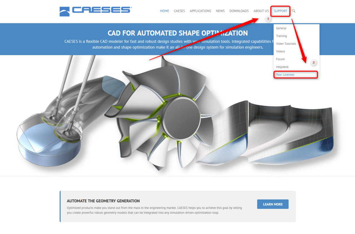

In case your license is stuck you can visit our web-page "www.caeses.com" and through "Support" you can reach "Your Licenses". There you can release your license if needed.

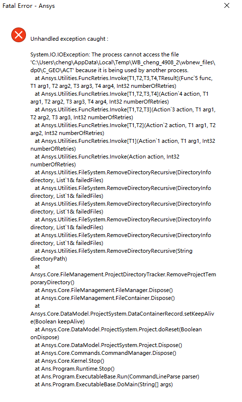

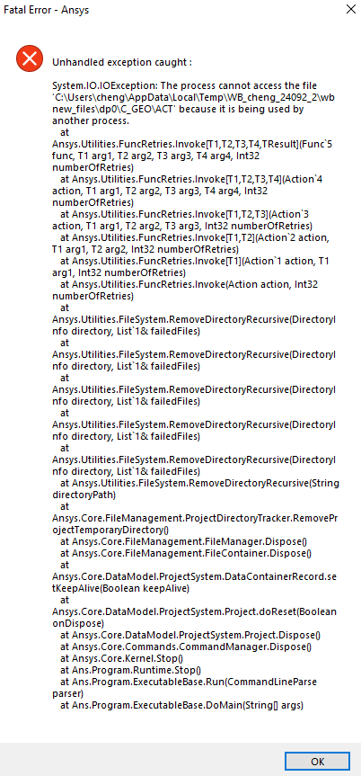

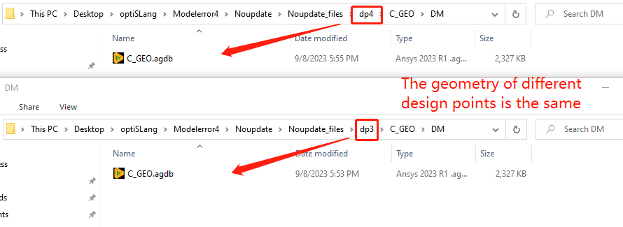

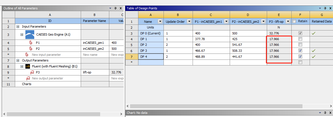

I've encountered another problem.
Workbench can import FSC files and recognize the geometry.
However, when I use Workbench DX to perform optimization calculations, the calculation results of all design points are consistent with the calculation results of the first design point.
May I ask what caused the problem? Looking forward to your reply!

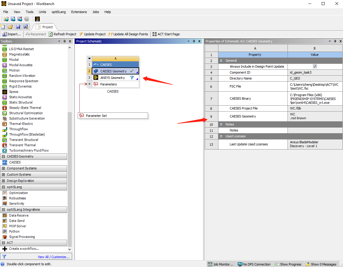

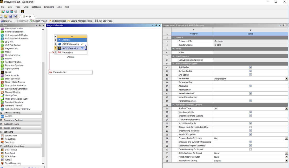

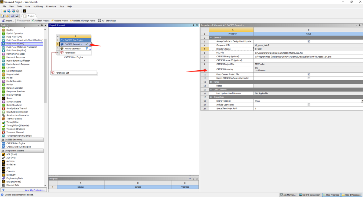

Hi Jake,
Can you please send to "erdem@friendship-systems.com" your fsc file and Caeses project file?
I need to check how the configuration is set up.
And also a screenshot form your workbench screen woulkd be great to see how you have performed the connections.

Hi Ceyhan,
Thanks for your help. At present I have roughly solved this problem. The method is to use a lower version of Workbench. I will contact you again if I still have this problem. Thanks again for helping me!
