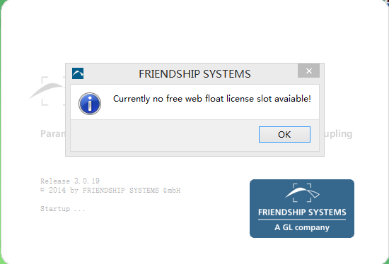

Mr. danile F 0 Report post Posted May 10, 2014 How to solve this problem? I have installed the many times. But the problem exist all the time! Share this post Link to post Share on other sites
Mr. Claus Abt 10 Report post Posted May 10, 2014 Nothing is wrong with this software. Your account has not been connected to the license - this might have various reasons that we can not always control. Please try again.If you want to learn how to use our software, I recommend to go through the tutorials that you can find in the documentation browser. Have funClaus Share this post Link to post Share on other sites

Mr. Görkem �ZBAYAR 0 Report post Posted May 16, 2014 Dear Mr.Lorenz, Mr. Abt I also receive the same notification when I try to run the CAESES. I've sent a license request to license@friendship-systems.com as well. What else should I to be able to run the programme? Thanks in advance. Gorkem Ozbayar Share this post Link to post Share on other sites
Mr. Konrad Lorentz 2 Report post Posted May 16, 2014 Hi Gorkem, please update to 3.0.19. You are using: 3.0.18__13.02.2014. This should fix the problem. RegardsKonrad Share this post Link to post Share on other sites
Mr. Görkem �ZBAYAR 0 Report post Posted May 16, 2014 Dear Lorentz, I also noticed it and upgraded my software now after uninstalling the older version.But I still face the same notice when I try to run the CAESES. Regards,Gorkem Share this post Link to post Share on other sites
Mr. Konrad Lorentz 2 Report post Posted May 16, 2014 Hi Gorkum, We could fix your problem (see PN). It was a problem related to your hostname (it is not compliant to http://tools.ietf.org/html/rfc952 ). Thank you reporting and testing. Have fun with CAESES. RegardsKonrad Share this post Link to post Share on other sites
