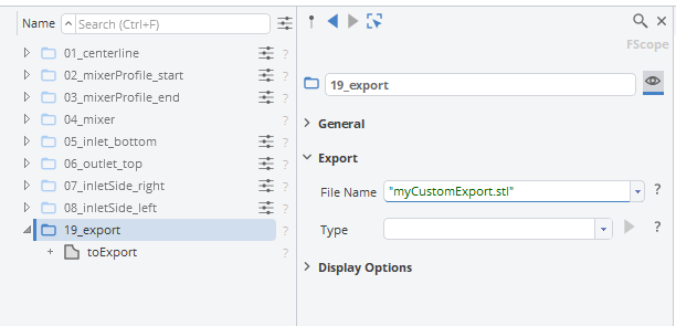

Mr. Heinrich von Zadow 12 Report post Posted March 17, 2023 Hi Katherine, maybe it is easier if you just run the fsc script in a unique directory for each design you want to generate -- this way also any other files generated by CAESES are taken care of. However, you can also adjust the name trough the fsc script. I'm guessing you set up your export by providing a scope (folder) in CAESES which contains the geometry you want to export and for which you have set a custom file name like this: Inside your fsc script you should be able to just change that name if you add a line like this: 19_export.setExportFileName("changeThisNameAsYouLike") You can also provide a fullName (incl. absolute path) if you want. BR, Heinrich Share this post Link to post Share on other sites

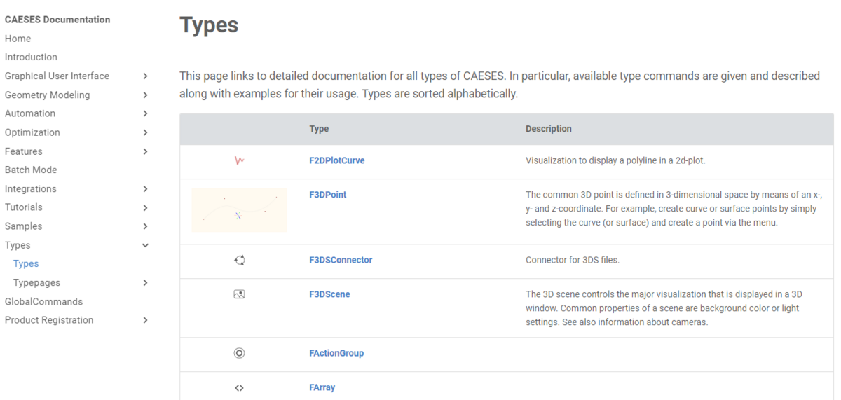

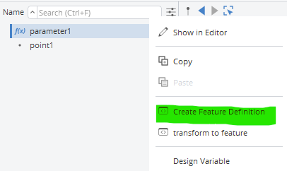

Mr. Heinrich von Zadow 12 Report post Posted March 21, 2023 Hi Katherine, I don't think there is a command to set just the path, not the name. In that case you would simply have to set the full name and path but keep using the same name. The commands available in fsc scripts are basically the same as in CAESES with the exception of things that require a GUI (e.g. screenshots are not available in batch mode). You can learn about most types and available commands through the Type documentation: Also, if you start typing a command (even if it is just a "." behin a certain object) you can always use ctrl + space in CAESES and see what the auto-completion has to offer: A third option many newcomers like to use is, to set things up in the GUI and then select a certain object or a whole bunch and right-click > Create Feature Definition: This will give you a new feature definition containing everything you had selected. BR, Heinrich Share this post Link to post Share on other sites

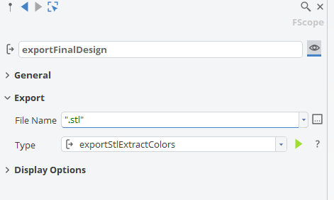

KNL21 0 Report post Posted July 6, 2023 Hi again, I have a bit of a follow-up to this topic: I would like to export STL's using the STL (Extract Colors) functionality. To export with Cases, there must be a name given for "file name", which serves as a prefix for all of the STL's I am exporting by color. Is there a way to get rid of this prefix, and to only have the names given by color used for the STL's? For example, in the attached screenshot when I use the file name ".stl", geometries are exported with names like "_leftInlet.stl", etc. - I would like to have the name be exported only as "leftInlet.stl" but the underscore that is attached to the prefix remains. Any help would be greatly appreciated. Thank you! Best, Katherine Share this post Link to post Share on other sites
