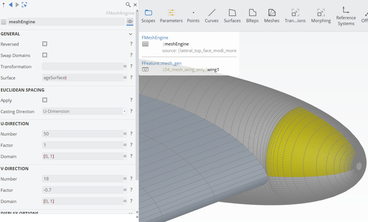

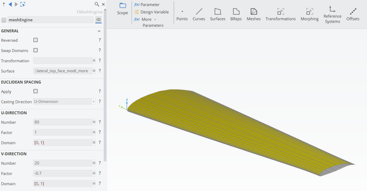

I am trying to mesh a wing using the meshengine. I want the mesh to be cosine distribution so it is more clustered towards the wing leading and trailing edge. I realize that with the mapping factor, if put in negative value, it will sort of give the result I want (see attached). And the larger the negative value , -1 --> -0.7 ----> -0.5, the more clustered the mesh will be in both ends. May I know what is the underlying formula that calculates the meshing spacing given the number of panels and mapping factor ? So I can understand better what goes on. Thank you.

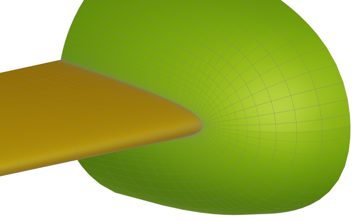

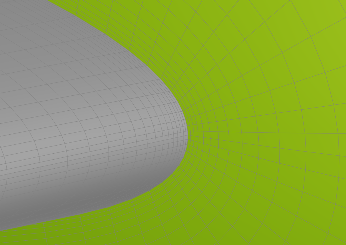

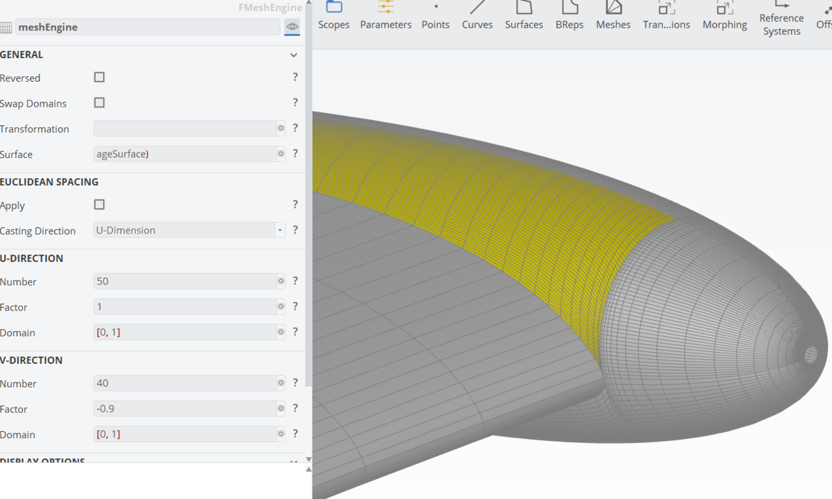

If you look at the attached images. I have a wing that is connected to a fuselage. At the intersection where the wing is attached to the fuselage, the wing and the fuselage joint patches  have same mapping factor, so their boundaries edges will be aligned. However, if you look at the surface in front of the fuselage joint patch,  I need to manually tweak the mapping factor (-0.7) so that I can have smooth transition in the size of the mesh from the fuselage joint to the fuselage nose.
It would be great if I can know for example, given the length and the width of a patch, and also number of panels in the u and v direction, what mapping factor I need to give so that I can make sure the size the mesh at the boundary of two neighboring patch, will have similar length and width, or aspect ratio.
