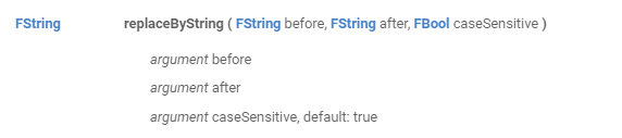

Mr. Heinrich von Zadow 12 Report post Posted April 19, 2022 Hi Alexis, the documentation can be searched i.e. for "String" which pops up all the corresponding class functions. You should be able to achieve what you are looking for with the replaceByString command: The problem with the backslash symbol is, that it is also used as an escape character. Therefore you need to use a little workaround e.g. as follows: FString s("a/b") s.replaceByString("/","\?") s.replaceByString("?","") Cheers, Heinrich Share this post Link to post Share on other sites
