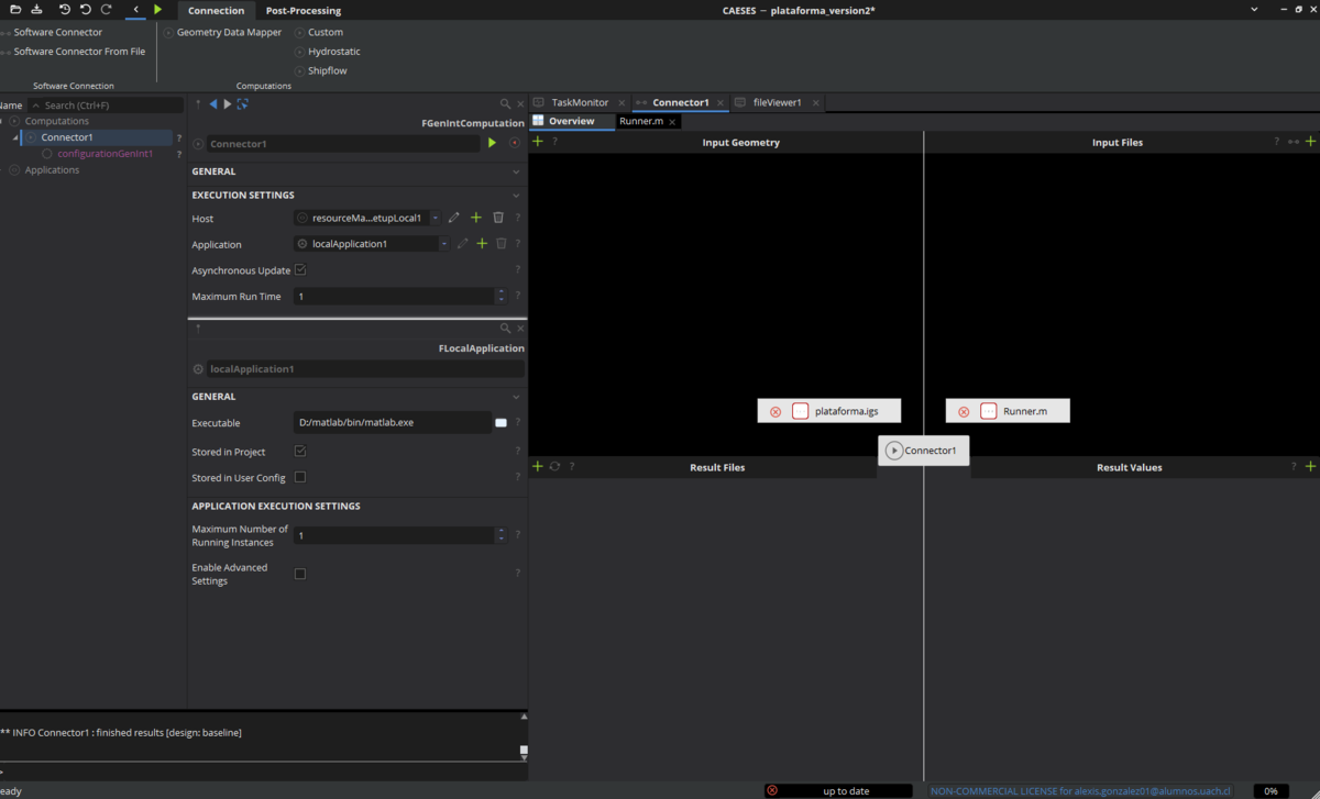

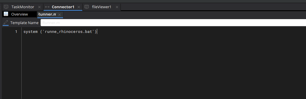

AlexisNav 0 Report post Posted March 31, 2022 Hello. I need connect Caeses with Matlab (Nemoh code), when run the software-connector only is launched Matlab, but is not launched my script, the script must execute a bat file. Thank you in advance Regards. Share this post Link to post Share on other sites
Ceyhan Erdem 14 Report post Posted March 31, 2022 Hi AlexisNav, I will recommend to check the tutorials with regards to Software Connection within CAESES. Locating a script file inside the "Input Files" quarter does not necessarily run it unless it is specified within your executable. Once you go over the tutorial files, please let me know if your problem is still unresolved. Cheers Ceyhan Share this post Link to post Share on other sites
